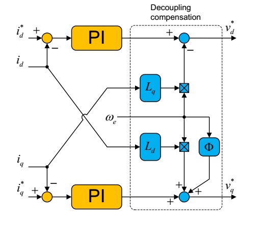

Dear Motorware Team,
I have a question related to MotorWare platform, that is: why I did not see the Decoupling code in implementing FOC algorithm?
Because this is a important feature to compensate "crossing couple between d and q-axis" when implementing FOC on synchronous frame (d-q) in any three-phase motors.
See the following figure:
I really want to know why MotorWare haven't added this module in its library?
Thank you for any discussion!
