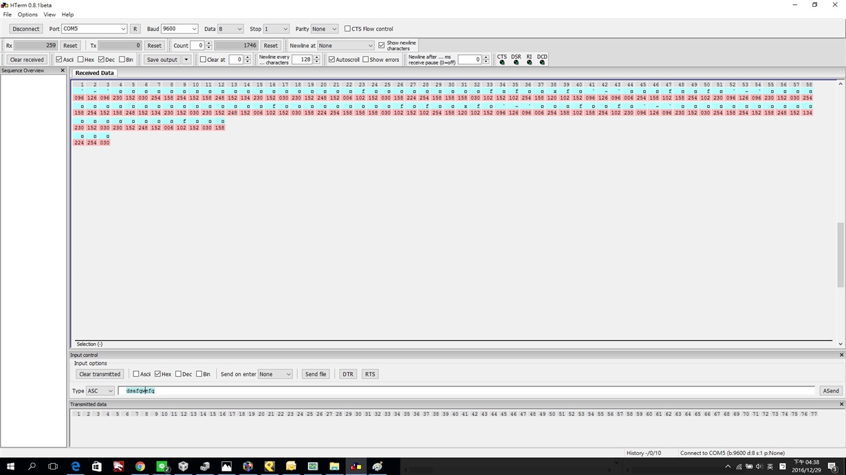

I uesd  ControlSUITE example code, 2837xDSci_echoback.c, to send the integers or chars, but the terminal always got the garbage signals from controlCard.
The SCI communication is through RS232 to send and receive data.

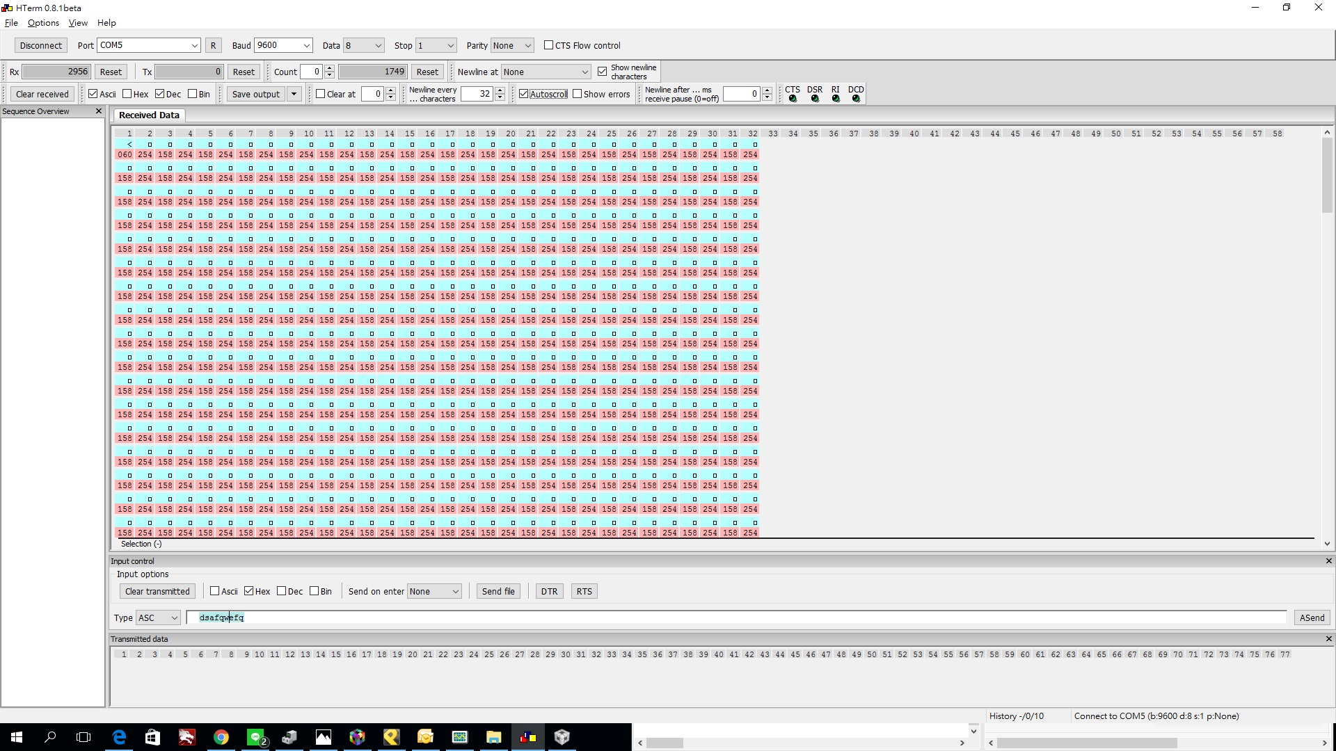

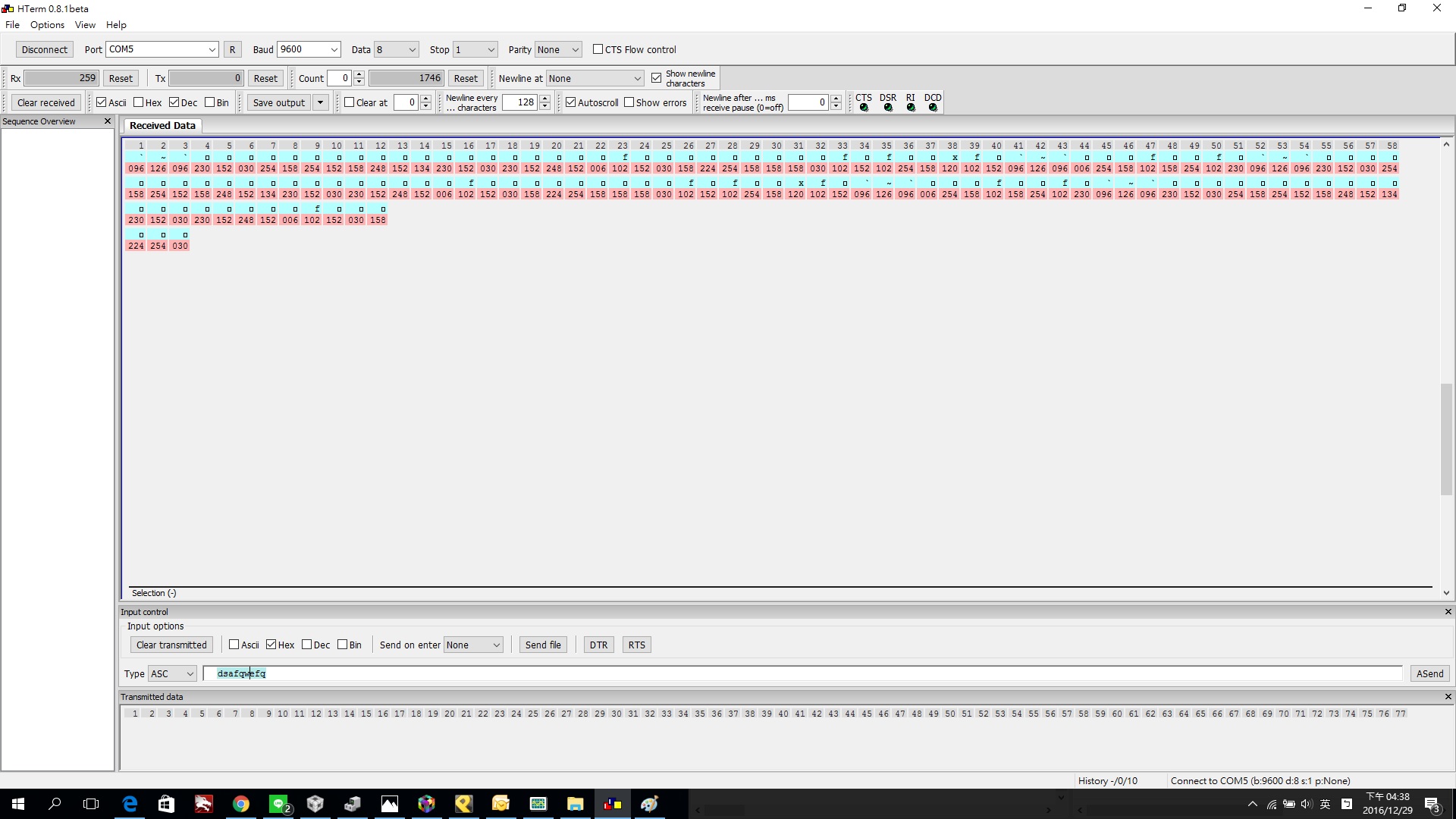

After debugging and executing, I get the garbage signals with controlcard.
There is the same result when sending the integers number loop from f28377, others setup doesn't change.
   for(;;)
       msg1 = 10;
       scia_xmit(msg1);
       LoopCount++;
Does there anything wrong with my code or hardware setup?
