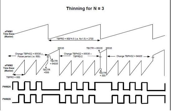

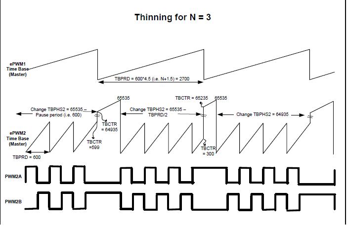

  • we've been looking at this, and the best method we've come up with is to use a spare ePWM timer as a "longer timer", that we switch in to do the blanking (or thinning)
    We use the synchronization feature of our PWM modules to achieve such switching by loading the TBPHS register with 65535 – Pause timeTBPRD/2 (applied every other N cycles). It is much simpler if we are running fixed frequency. Also, the + ½ cycle requirement is going to make us change the TBPHS register after every N cycle and that is why the factor TBPRD/2 in the above equation. The mechanism, however, will all be in the hardware. If we didn’t have the ½ cycle requirement, then there won’t be any software involvement other than what would be needed for the changing switching frequency.

  • Hey Chris,
    Let me see if I got this right... the above scheme will potentially blank pulses at arbitrary points in channel 2's waveform, correct? The example you show above is benign in that the blanking causes the waveform of channel 2 to just continue in its current state. However, there is nothing to guarantee quick transitions up and down if the sync pulse comes after a recent transition.
    For my application, I am using a fixed frequency, and it is tantamount that the on and off time add to the cycle period. For example, if my cycle period is 1uS, then a duty cycle of 0.4 means 400nS of on time and 600 nS of off time. Blanking the next pulse would mean that the next cycle has 1uS of off time. The difference I am trying to illustrate is that this is not the same as 400nS of on time and 560nS of off time, at which point the sync pulse comes and blanks the next pulse for 1uS since the counter is reset. That additional 40nS of off time from the first cycle MUST be there in my application.
