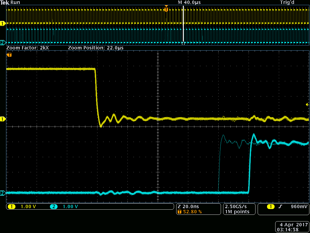

Hallo,
is it possilbe to creat two PWM signals using HRPWM for the period and the duty cycle and use a fix deadband?
I want do create EPWMxA with a specific period and duty cycle and EPWMxB should be the inverted signal of A with the same deadband. I modified the hrpwm_prdupdown_sfo_cpu01 Project from the controlSUITE examples. But there is always a jitter on channel B.
How can i avoid the jitter?

    Can you attach some oscilloscope images highlighting the jitter? I have your code loaded and am looking at it right now but I don't believe I'm seeing the jitter issue.
    Also, can you verify these two lines? What values are you writing?
    EPwm2Regs.DBRED = EPWM2_DB; // rising edge delay value
    EPwm2Regs.DBFED = EPWM2_DB; // falling edge delay value
    One thing you may want to try instead of inverting in the deadband submodule is using HRCNFG[SELOUTB] to invert the B channel and see if that fixes the issue.
    Kris
  • Hi Kris,
    EPWM2_DB = 5;
    Do you mean instead of setting DBCTL[POLSEL] setting SELOUTB = 1;
    Do you know where to place the SELOUTB = 1;
    Here is an example of the jitter:
  • Jonas,
    I suspect that the same thing is happening on the A channel but your trigger settings are masking it. Can we try measuring the pulse widths of the A channel and B channel and also the dead time between them?
    When you started with the original controlSUITE code, were you seeing the issue then or only after adding the deadband code? I'd like to simplify the setup as much as possible to verify where the issue is. Let's start back with the controlSUITE code and check that.

    I have the project running and am seeing the jitter as well and investigating the source. Can you confirm that you are also seeing jitter on channel A?
    Kris
  • Jonas,
    Try adding this line to your initialization code:
    EPwm2Regs.CMPB.bit.CMPBHR = (1 << 8); // initialize HRPWM extension
    This fixes the issue on my end. Your setup is configuring HR control on both edges, but the CMPBHR extension is not initialized.
    Kris

    Which of the projects to you mean. I added EPwm2Regs.CMPB.bit.CMPBHR = (1 << 8); // initialize HRPWM extension to my code but this did not fix the issue. Still seeing jitter on ADC_PWM_ASSM_LIB_JITTER and on the other project after insert this code.
    I can the jitter on channel A too if i am triggering on channel B.
    You don't see jitter after adding EPwm2Regs.CMPB.bit.CMPBHR = (1 << 8); // initialize HRPWM extension to the code ?

  • Hi Kris,
    there run into an error. But after changing
    EPwm2Regs.DBRED.all = 10; // rising edge delay value
    EPwm2Regs.DBFED.all = 10; // falling edge delay value
    to
    EPwm2Regs.DBRED = 10; // rising edge delay value
    EPwm2Regs.DBFED = 10;
    i can see the PWM signal without jitter.
    I tried the EPwm2Regs.CMPB.bit.CMPBHR = (1 << 8); // initialize HRPWM extension on the other project loaded up as .zip file and there the jitter still occures.
    Can you confirm that you also see jitter on the other project?
    Why did you comment the sfo function out ? Thought the value of the sfo function has to be updated continuously.
    Thank you,

    The change in the DBRED/DBFED registers was due to an upgrade in our header file generation after v130. This was a major improvement to provide consistency for the future of C2000 moving forward. In such, there were a few tweaks that had to be made and these registers were one of them. I do strongly recommend moving to the latest versions of all of the header files where possible as they incorporate tweaks and customer feedbacks each release.
    Kris
  • Hi Kris,
    i moved the project to v210. Then i tried the configuration for the EPWM2Regs like in the one you posted here. The only thing i changed was to create another interrupt for the adc conversion.
    EPwm2Regs.ETSEL.bit.SOCAEN = 0; // Disable SOC on A group
    EPwm2Regs.ETSEL.bit.SOCASEL = ET_CTR_ZERO; // jitter
    EPwm2Regs.ETPS.bit.SOCAPRD = 1;
    But there is still the jitter problem. like before.
    Did you try to run the other project which has an adc interrupt ( .zip file) ? Did you see jitter ?
    What flags have you set while running the project ( C2000 Compiler , C2000 Linker)?
    Thank you very much,
    Jonas
  • Hi Kris,
    i have an update regarding to the file you post here without jitter.
    There is an interrupt named epwm2_isr
    in line 425 there is a comment with
    //update_T_PWM(PWM_Periodendauer);
    Can you please comment it in and the following line out.
    l.432
    EPwm2Regs.TBPRDHR = 0x3333;
    If i am doing this i see jitter on the version you send to me. Can you prove this.
    Jonas

    After reviewing the advisory in the errata, I changed all of the bitwise writes to HRCNFG to one .all write and it seems to have gotten rid of it.  Can you try this on your device?
    The value I calculated was:
    EPwm2Regs.HRCNFG.all = 0x1353;
    Here's the errata for your review (search for HRCNFG):
    I don't have access to a scope with enough resolution to see HR movement today so I'm limited in testing. I can confirm the jitter has gone away, but please verify the HR movement is still proper.
    Kris
  • Hi Kris,
    i have revision code C ( using TMS320 f2877SPZPT YFC-67A616W G4 )
    I delteted every EPwm2Regs.HRCNFG.bit.xxxx and set
    but i still see jitter.
    Jonas
  • Jonas,
    Thanks for the information. In update_t_pwm(), can you add the following line after you write to CMPAHR at the end of the function?
    EPwm2Regs.CMPB.bit.CMPBHR = CMPAHR_reg_val;
    Kris
  • Hi Kris,
    i can will try this tomorrow and give you feedback. Why do you want to write the High resolution register of the CMPB register?
    Did you have jitter on a board with revision C too?
    Jonas
  • Jonas,
    I think I had halted the processor execution when I was debugging earlier. When I loaded the program again I did see B channel jitter. I'm pretty confident this is going to resolve your issue.
    Kris
  • Hey Kris,
    I tried it with
    and the jitter seems to be gone. I thougth i inverted EPWMA so the CMPB register should have no impact on the EPWMxA or EPWMxB. Can you explain this please?
    I will try it with the other project an give you feedback. Thank you for helping and thank you for your time.
    Jonas
