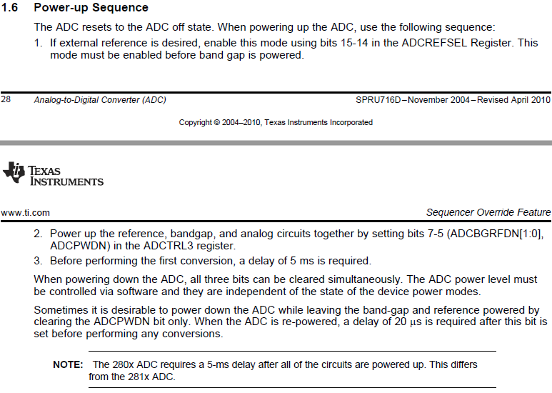

Part Number: TMS320F2808
When I'm initialising ADC to measure voltage amplitude, not getting a proper ADC digital value and i'm thinking may be missing of [ADCPWDN] bit & DELAY() on the initialise code. Here's some assumption, may be to correct the Digital value.
# ADCPWDN (ADC power down) register is most really required to initialise ADC peripheral technology?
# If i don't used the ADCPWDN register, can be ADC peripheral technology works?
# Is it work, if i used all necessary ADC register to measure external signals except this ADCPWDN register bit?
