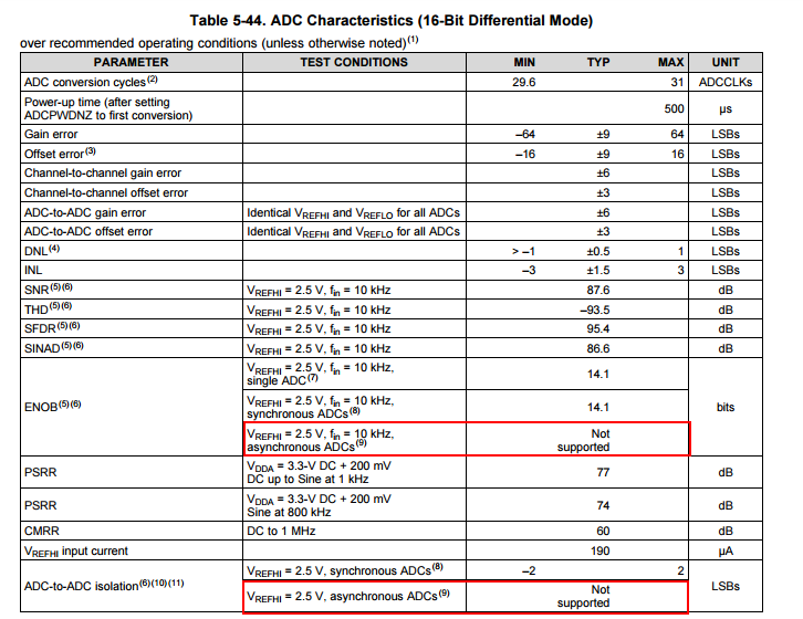

    Have you looked at the section in the TRM on how to maintain synchronous sampling? We wouldn't recommend running ADCA on its own asynchronous to the other ADCCs, especially if you are using 16-bit mode for some of the ADCs. Instead, you can (manually) switch the resolution between groups of conversions on the same ADC.
  • Yes, I've been consulting the TRM for a bit and found it can be quite confusing at times, like the mention of SOCC and SOCD that might be a typo.

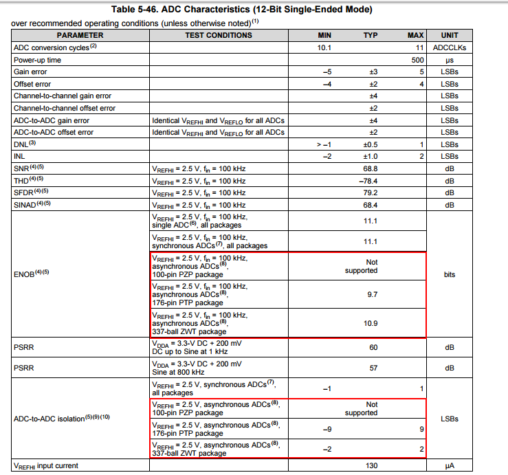

    If you use ADCA independently from the 16-bit ADCs, then the 16-bit ADCs may operate asynchronously to the 12-bit ADCs. This will affect the performance of both the 16-bit and the 12-bit ADCs, but the effect will be much more noticeable in the 16-bit ADCs. We actually explicitly don't support this mode of operation, because the performance will be quite bad.

  • Hi ED,
    The performance will degrade.  For 16-bit, the performance degradation is pretty bad, so we don't suggest/support this mode.  For 12-bit, we specify what the performance degradation will be for ENOB and ADC-to-ADC isolation (basically internal ADC-to-ADC cross-talk):
    You can read more about what does/doesn't qualify as asynchronous in the TRM in the section titled "Ensuring Synchronous Operation", but the short description is that you want to operate all the ADCs in lock-step...so for a given ADC use the same resolution and signal mode configurations and for each SOC use the same trigger sources and same S+H duration (different channel selects are OK).
    There is no waiting time required between changing the ADC resolution and sampling again.  The preferred way to do this is by using the ADC setMode function.  If this takes too long, you can also just flip the bits for resolution and signal mode...in this case use the function to set the mode to 16-bit to load the correct trims...there will be a slight performance degradation in 12-bit mode due to not loading 12-bit specific trims, but this is not a significant performance hit.

    Was thinking a bit about this scheme... What happens if sampling one of the resolutions is a lot faster than the other, i.e. NOT interleaving (or what you may have referred to as LOCKSTEPPING?)? Let's say the faster 16-bit samples are read in the ISR, then resolution is changed to 12-bit, but the next conversion is still 16-bit before a slower 12-bit sampling is triggered. Would that create a problem for the 16-bit samples being read as 12-bit?
  • Hi Ed,
    You will definitely want to make sure that all samples are complete before switching the resolution.
    There isn't any danger of damaging the device by sampling in the wrong resolution.
    If the sample was supposed to be 16-bit but was triggered while the ADC was in 12-bit mode, the sample should actually be OK, just only in 12-bit resolution and not benefiting from any common-mode noise rejection from differential signaling.
    If the sample was supposed to be in 12-bit mode but was triggered while the ADC is in 16-bit mode then the sample will likely be corrupt because the ADC will sample a differential pair of signals that are unrelated and not really a differential signal pair.
  • This is not good news at all. Like I said we intend to use the 12-bit module ADCA completely independently of the other 3 16-bit modules, which can mean random sampling as well. Per your explanation it is not possible this way. There must be some kind of lockstep or interleaving relationship between ALL the modules for the mixing of resolutions to work properly. If it's true it could be a major weakness of the ADC feature!
  • Hi ED,
    That is accurate; if you are using a mix of resolutions you will want to treat the 4 ADC system as a single ADC that can do 4 conversions in parallel. If you don't have conversions that go in some slots, then you do a dummy conversion. You want to switch the whole system between resolutions all at the same time. This could get ugly if you have multiple asynchronous loops since you need to be sure the ADC is not converting to switch the resolution.
    If you are using only 12-bit resolution, you can operate the ADCs independently/asynchronously on the 176-pin and 337-ball packages with some performance degradation. On the BGA package the performance degradation is pretty minimal.
