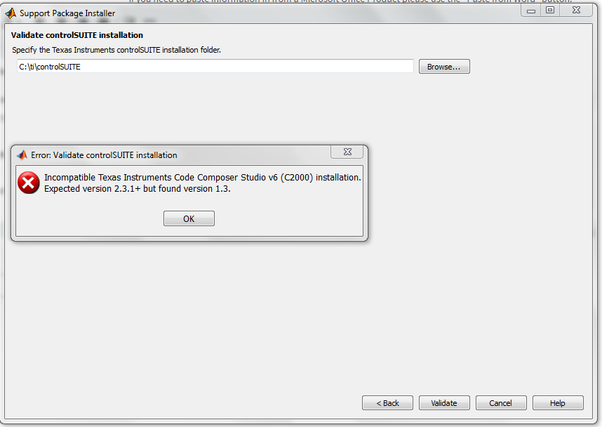

I want to install mathworks addon for TI C2000 microcontrollerI (have TMS320F28377S launchpad).
I have downloaded and installed the mathworks add on at the end of installation it asks for validation for two installed softwares CCS and Control Suit. I Have latest version of both installed on my PC(CCS-7.1 & Control Suit-3.4.5). I have matlab R2015a.
But when i choose the validation for control suit it shows me error
"Incompatible Texas Instruments Code Composer Studio v6 (C2000) installation.
Expected version 2.3.1+ but found version 1.3."
I have latest version 3.4.5 installed still it shows found version 1.3.
Kindly help me with this.
I also checked that validation checks for one txt file "Release Notes.txt" and it is present in the directory of control suit.
I am attaching the screenshots of error messages.
Kindly help me with this as early as possible.
Thank You.
  • Hi Mandar,
    MathWorks does not yet support CCSv7. You need to install CCSv6 to proceed.
    Also, we started supporting F28377S in Release R2015b - so you must use that release (or newer) to work with your LaunchPad. R2015a wont work.  Note that CCSv7 came out in Dec 2016, while your MathWorks SW came out in March 2015; CCSv7 didn't exist when R2015a was being developed back in 2014.
