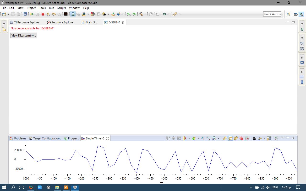

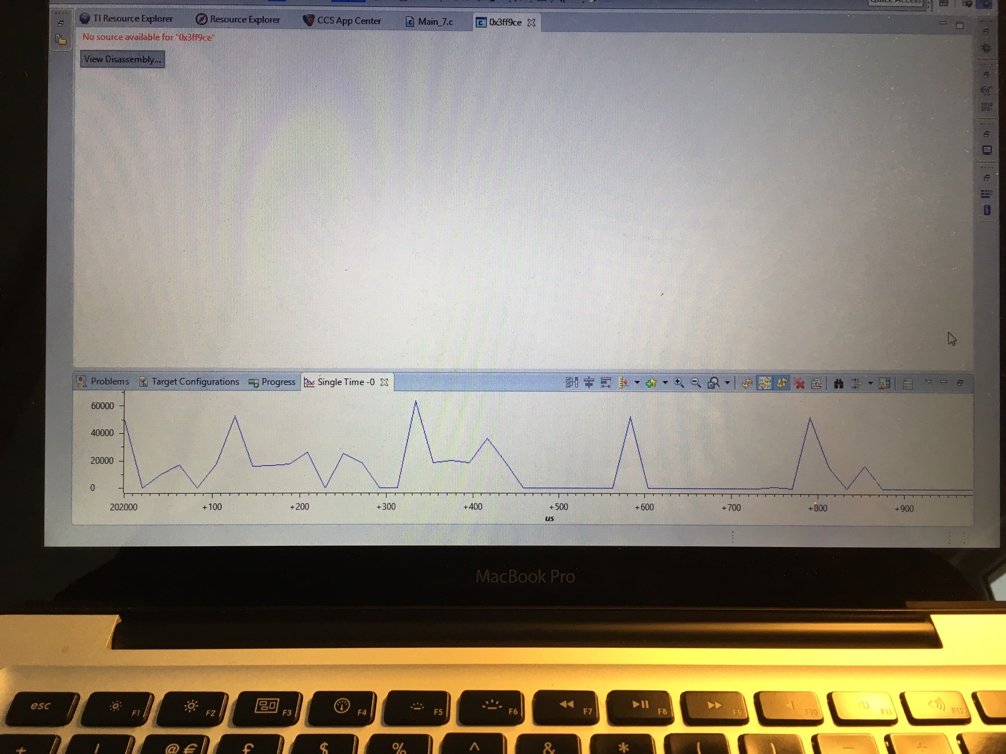

ken,
I jumped directly to ePWM solutions files in order to know if that works. When I run the lab7 from the start button I get a normal PWM. When I use Run_realtime_with_reset then I get something weird.

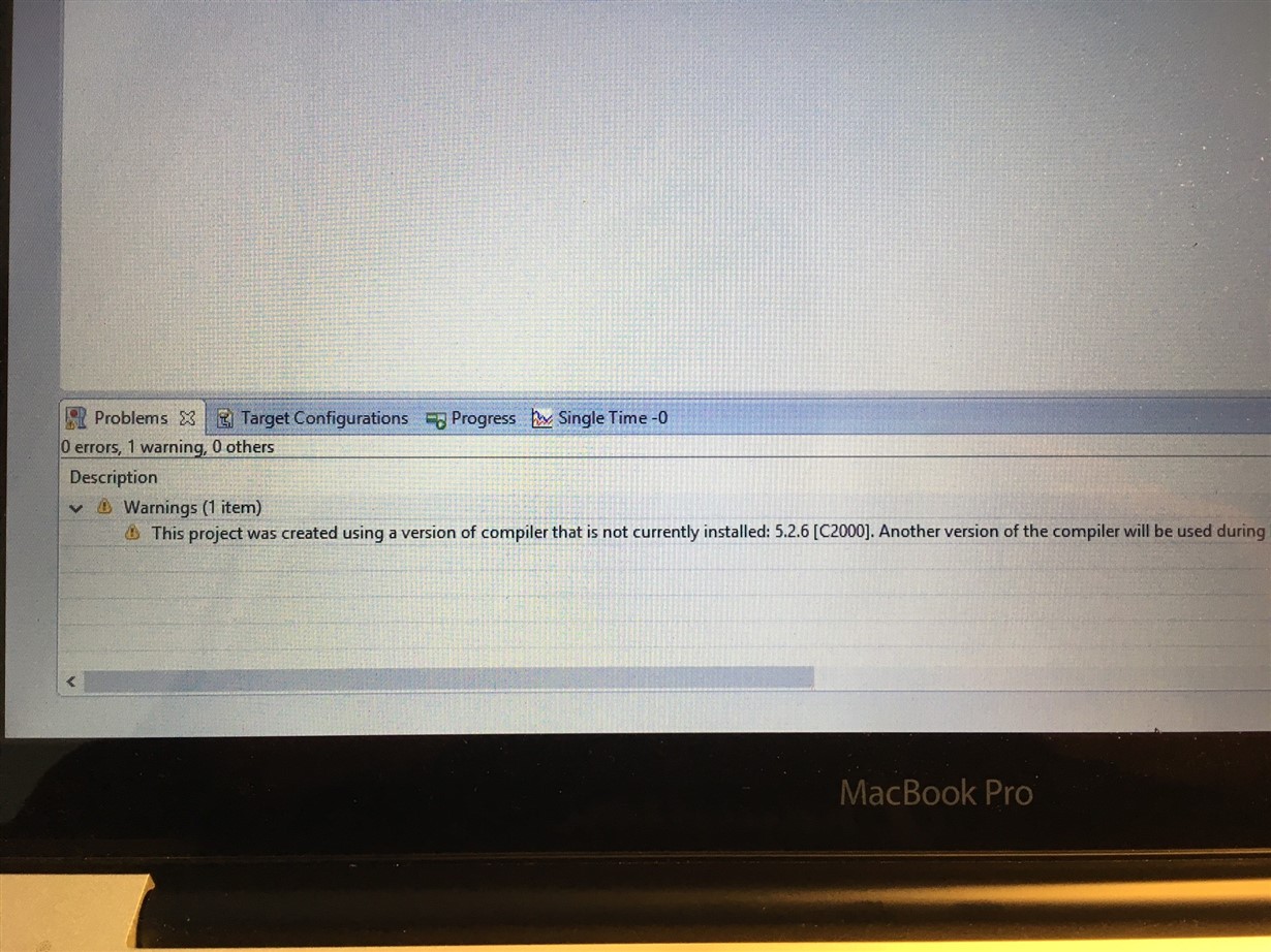

I have noticed that a shunt jumper is missing and that the compiler version of the lab7 is an older one. I tried to install the previous version through Help-install new software but there is no C2000 category.
Kostas,
Since you are getting the PWM with 'run' then it is working. When using the script for real-time mode a reset is issued. Double check that the boot modes are set properly - see Appendix A. For this exercise, it should be set to boot to SARAM.
- Ken
