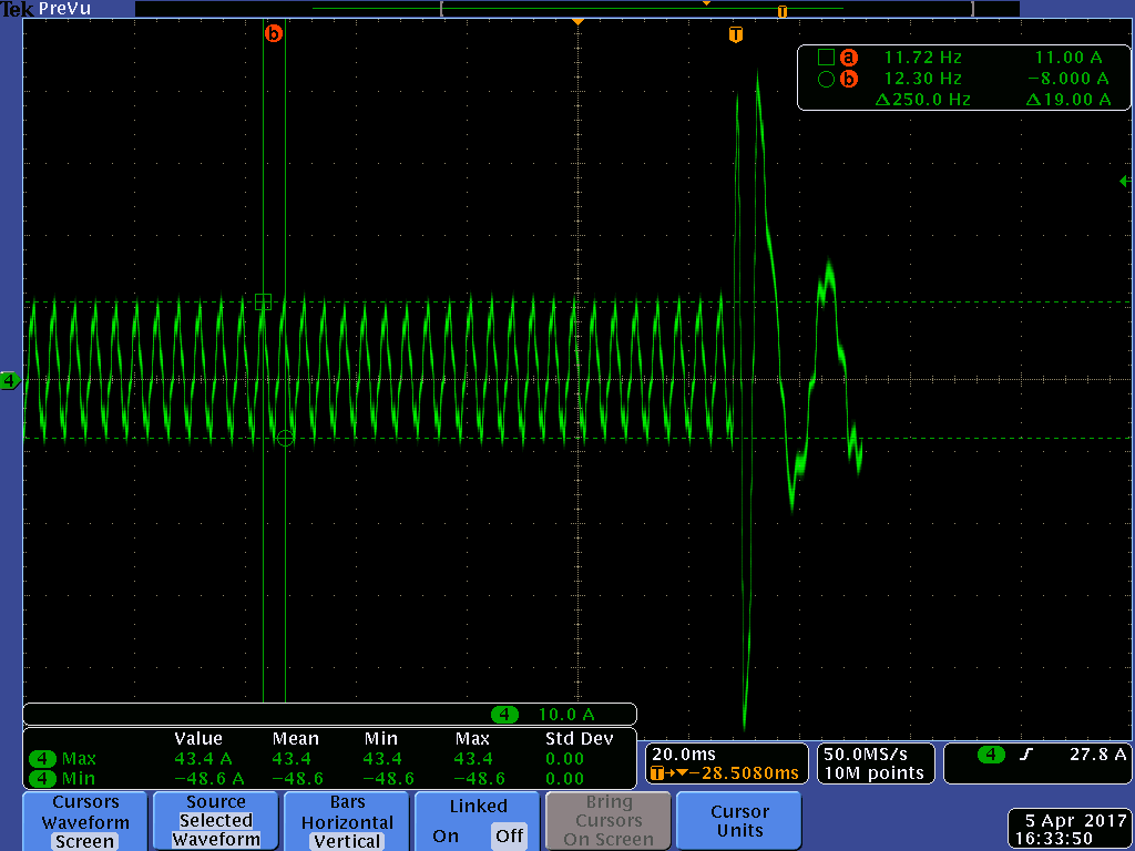

We are having an issue where when running our pumps (mostly identical to the LaunchXL-F28069M + BOOSTXL-DRV8301 EVM) but with 2 pumps per picollo.  We are reaching some power limit that we don't understand.  Both pumps run at 12V,  ~10A peak/peak (8k RPM) when looking at the phase currents (on the wires to the motors).  We can run each motor individually OK at that current, but when we run both pumps, we can run one up to that current, but once the 2nd one runs up and hits about +/- 9A,(7000-7500 RPM) the 1st one will lose sync and generate a huge current spike +/- 40A for cycle causing it to stop and restart.

Here's the waveform at the event...
Thanks for any help!

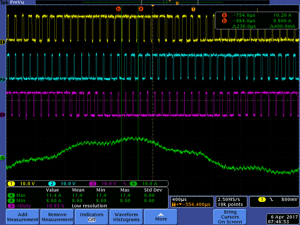

  • update --- we looked at the PWM signals at the motor  and we are hitting the 88% duty cycle limit (as we just use 2 current sense resistors). We were able to increase the 12V DC bus up to 14V, and got a little more performance.
    Interestingly, in spruhj1g, it says USER_MAX_VS_MAG_PU (1.0) for sinewave, but in the motorware userxxx.h files is says (0.5).
    we are using 0.5, is that correct?
    Is there any way to get above 87% duty cycle on the PWM with just 2 current sense resistors? any little bit will help.
    thanks
  • 1. Disable OVM function, and set  USER_MAX_VS_MAG_PU to 0.5 if you want to use 2 current shunts.
    2. Check your power supply whether have current limit. If no, try to increase power supply voltage to check the running performance.
  • thanks - we disabled OVM which seemed to run the motors smoother. We also increased the voltage which allowed us to run at a slightly higher power level. It appears that we are just hitting the top of the power curve for our design.
