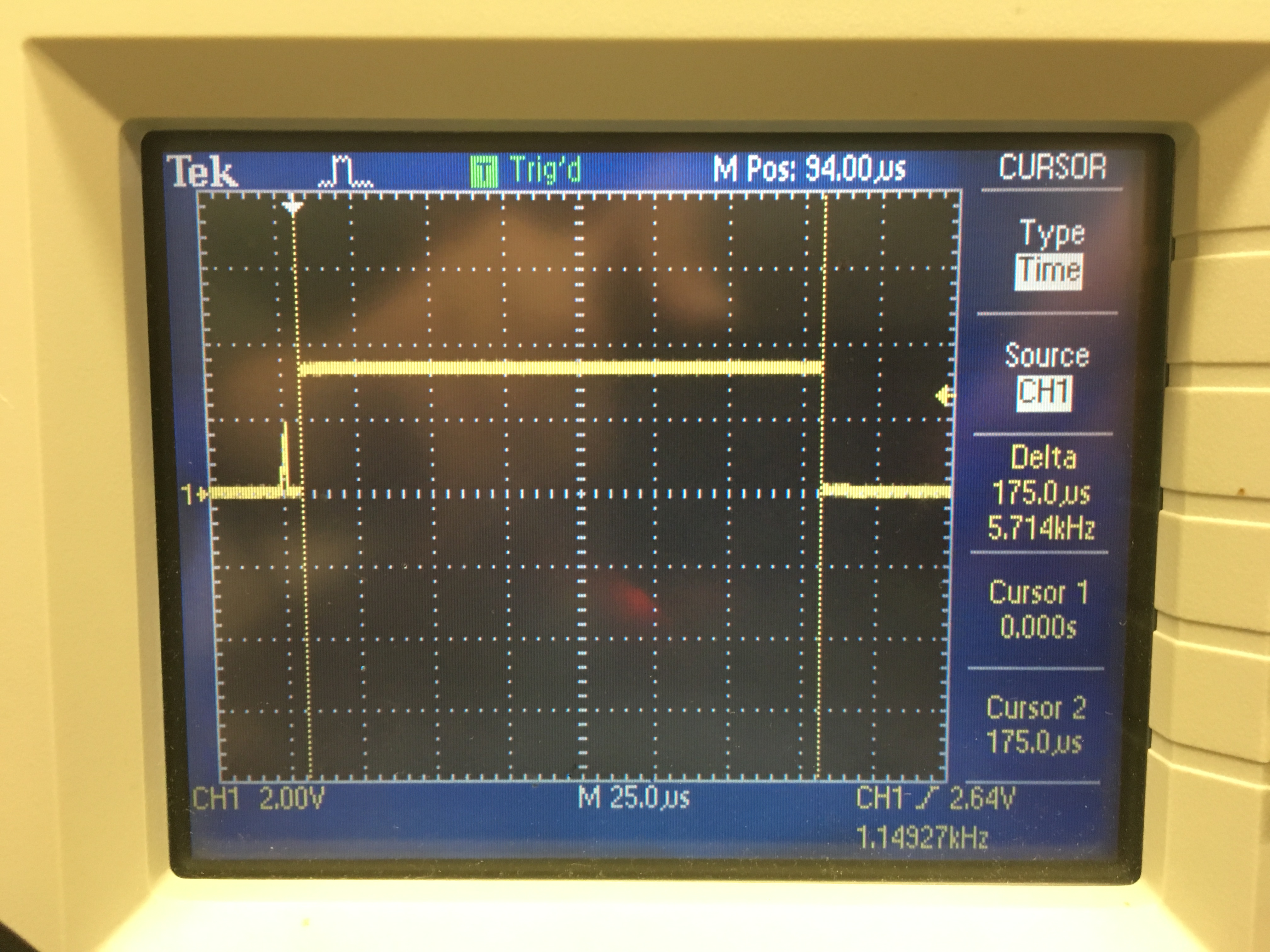

  • Dalen
    Please provide some oscilloscope captures. Also, verify that your phase and polarity settings agree between the devices. I know that the C2000 SPI does not necessarily match the Wikipedia definitions. seems like you might be just sampling the data on the wrong edges. At a first glance, it looks like you might be "getting lucky" and getting the correct bit value. I do find it odd that even 0xFFFF is not sampled properly, so that might not be the only thing.
    What SPICLK frequencies are you operating at?
  • This picture below is when the TMDSDOCK28335 is sending 0x274E, and I am receiving 0xA713 (as stated in the chart). Bits change roughly every 10us (or 100kHz). I also think the "spikes" at each end are start and stop signals? Also, it appears that the data is right, but I may be reading it in wrong.
    This picture below is when TMDSDOCK is sending 0xFFFF, but I am still receiving 0xFF7F. Again, the data coming in is right, but is being read wrong.
    This picture below is when TMDSDOCK is sending 0xABCD, but I am still receiving 0xE655. Again, the data coming in is right, but it appears there is an extra high bit tagged on the end.
    This picture below is when TMDSDOCK is sending 0x5555, but I am still receiving 0xAA2A. Notice that the fourth high bit stay high for twice as long as it should, and so does the last bit.
    If you look at my comment on line 98 of the CC3200 code, the clock polarity and phase has been set to 0 using the macro SPI_SUB_MODE_0. On the TMDSDOCK28335 code, the register SpiaRegs.SPICCR.all is equal to 0x008F (0b0000000010001111). Bit 6 controls the clock polarity, and when this bit is set to 0, data is outputted on rising edge and data incoming is falling edge. The register SpiaRegs.SPICTL.all is equal to 0x0002 (0b0000000000000010). Bit 3 controls the clock phase, and when this bit is set to 0, then normal SPI clocking scheme (without being delayed one-half cycle). I have all of this as comments in both code sets, plus more, if you need any more information on why I set the registers as I did.
    The bit rate set by the CC3200 is 100,000 bits per second (there is a macro setup for it on line 24). So that should make the SPICLK pin be 10uH.
  • Maybe someone from the CC3200-LAUNCHXL would know what is happening? Since it appears the data is coming in correctly, then I am guessing that the CC3200 SPI peripheral is reading in the data wrong.
  • Dalen,
    I am concerned with those spikes in your code. they should not be there. I will see if I can get a CC3200 rep over to this post.
    Can you share the scope captures with additional signal lines? A clock reference would be very useful here. If you can also add the SPISTE with the data on another plot if you cannot fit them all on that scope. I think those runt pulses will correspond with the SPISTE being driven before and after the transaction.
    Have you tried slowing down SPICLK to test? If this helps, there may be some timing questions that need to be addressed.
  • Hi Dalen,
    Yes, the additional signal lines will be needed to analyze what is happening. Please add in the Clock and CS lines to a couple of the captures.
