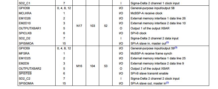

  • Hi Manoj,
    Thanks for the response. Are you sure that GPIO58 and GPIO59 are for SDFM1 channel4? When I look in the datasheet for the TMS28377S datasheet, I see the following... (is there another pin that GPIO58 and GPIO59 can be configured to)?
    I'm working on integrating the SDFM drivers, but it is a little finicky in a MATLAB / Simulink Embedded Coder environment. That is initially why I was trying to manually assign the registers. That way I could verify that the Sigma Delta Module was working properly independent of MATLAB environment problems / issues with integrating external drivers.

  • Daniel,
    My bad. I was looking into F280049 DS instead of F28377s.
    Ignore the SDFM setting statements I mentioned above. But, GPIOMUX configurations are still correct.
    Manoj
