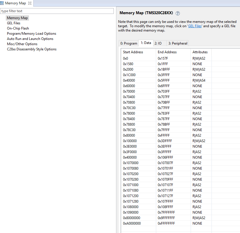

CCS/TMS320F28377S: Loaded .out built for RAM into FLASH, con no longer program FLASH
Part Number: TMS320F28377S
I have several 28377S-based boards that were mistakenly flash programmed with a .out file that was built for RAM. I can no longer erase the 28377S parts in Uniflash or program in CCS 6.2. I'm using a TI 100v2 jtag adapter. When I connect to the target, without a project, the gel file executes but the memory map displayed in the GEL files tab does not match the memory map specified in the F2837x_Memory_Map() within the gel file. I've inserted a screen shot below. Any suggestions on how to fix this?
