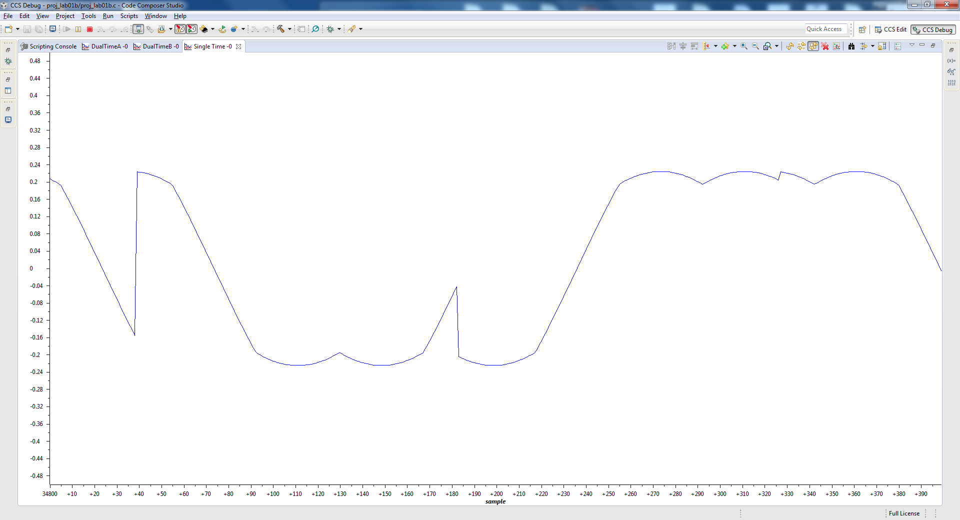

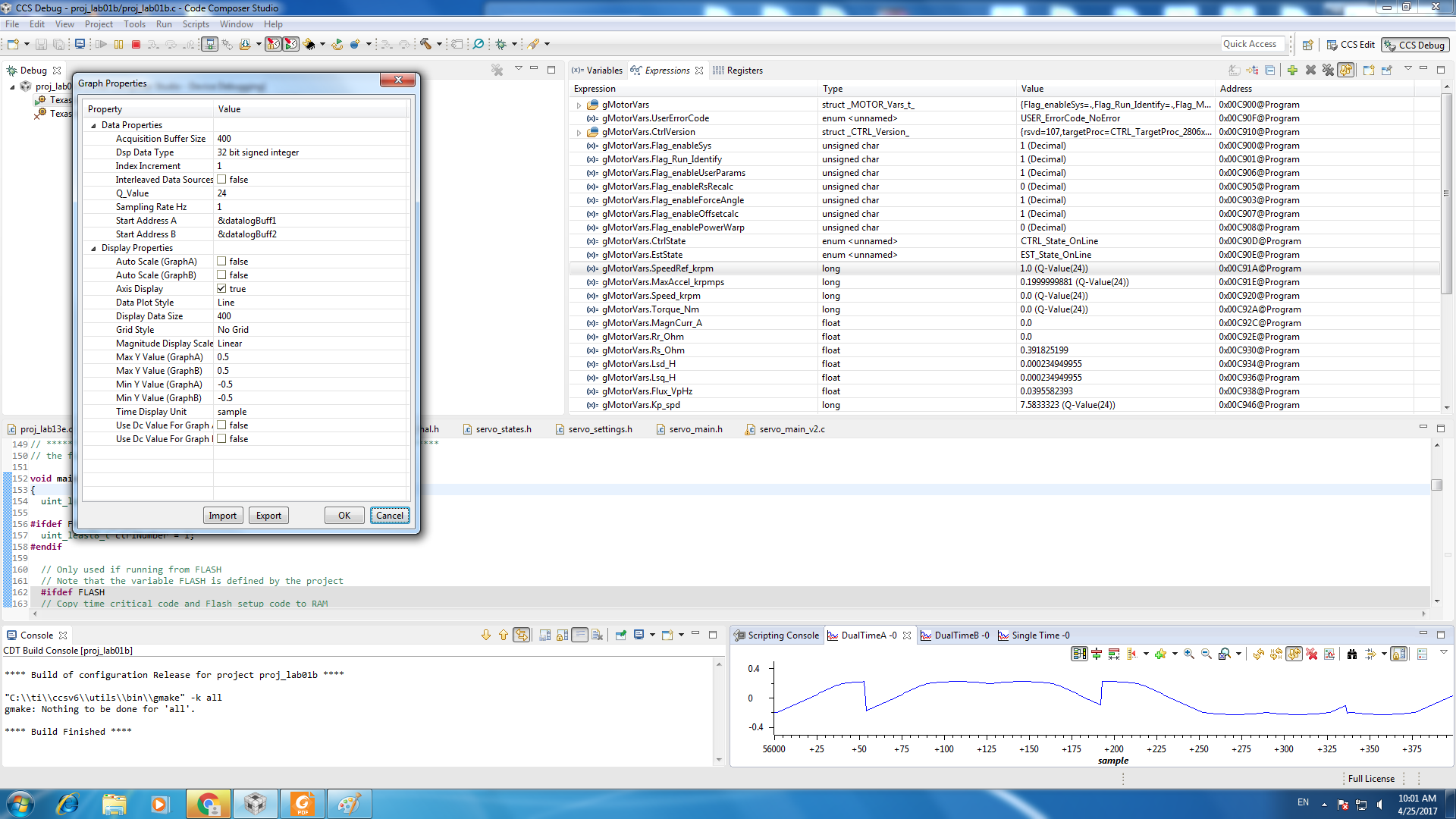

I want to use DATALOG module which is introduced in MotorWare 18, Lab1b and Lab1c to show my signals while developing my project. But when I tried this module by running Lab1b and 1c, I could not get the real-time data logging results.
The strange is I could not receive the smooth signal like the demonstration in the document InstaSPIN Projects and Labs User's Guide (for MotorWare 18).
Below is my results when running Lab1b:
Please help me to solve this issue,
