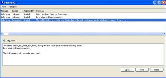

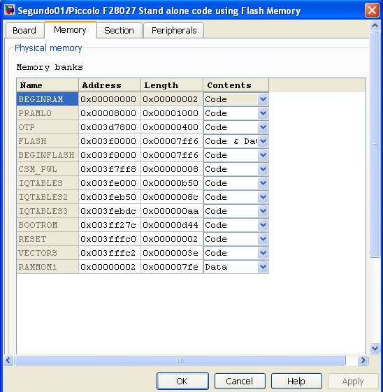

    Let me explain, I´m working on a Simulink Model that I name it Segundo01. I tried to build this model (Ctrl+B command) but the error that I show you above appears. That is the main problem.
    Then I tried to load a simple example using CCS ( Without Simulink ), I not interesting in this because I need to work with Simulink, I just used it to verefy the flash. It work finally. But again, i need to do this with simulink. Why? Because i need more memory space, i'm using the RTDX block ( C2000lib---> RTDX Instrumentation), using a lot of sensor, interface with GUIDE.
    Again, i´m not interesting in CCS because all the work I did is in Simulink. I'm not re-configured CCS i just follow the step for prgramming the flash. But this is not the Main problem.
     I read the link that you send me, but again i can't build the model. Look this(CCS error):
    this is the error that matlab shows:
    Questions:
    1) Is there an simple example that you can send me (Using Flash in f28027)?
    2) Could be a Memory location problem?
    I know you don't have to configure CCS, because Simulink did it for you when you build the model (Work in Real time ). Maybe i´m doing something wrong, but i guess that just by adding the Piccolo stand alone memory flash is enought.
    This is the first time I'm using Flash with Simulink.

  • Hi Gaston,
      Regarding the Flash Programming issue, I meant to ask this earlier: Which System Target File are you using for the code generation process for your model?
    You can obtain this information by entering the following at the MATLAB Command Prompt:
    >>open_system(modelName)
    >>get_param(modelName, 'SystemTargetFile')
    Or you can go to the Simulation -> Configuration Parameters in menu bar of the model and select the Real-Time Workshop pane.
    The name of the System Target File shown should be "idelink_ert.tlc". If this is not the case, please reply with the name of the System Target File that does appear.
    Cheers,
    -Greg
  • Hi Greg,
    The Sistem target file is idelink_ert.tlc.

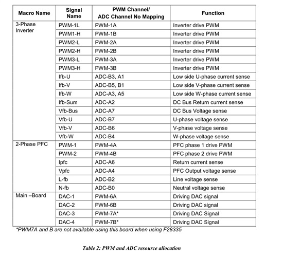

  • dear;
    I have f28035, but i have aproblem to set the ADC in simulinnk to read the current of the motor, i have high voltage kit !! can you hep me to solve this problem?
    thanks
  • thanks, ChrisClearman
    from the documents of high voltage kit (1.1): can you give me the information about which ADC for currents of the motor and which for ac-voltage and dc-bus voltage?
    i read it but can not understand?
    as example:
    Ifb-U          ADC-B3, A1        Low  side U-phase current sense?  A1 or B3??
  • ahmed,
    we mapped the same signals to multiple ADC pins for flexibility and so we could do dual S-H if required (notice that each current shares a A#/B# with another).
