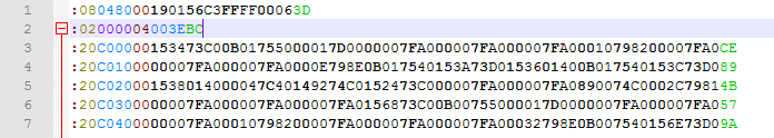

Here is a start of an example, which I generated via Hex2000 with options "-romwidth=16 -memwidth=16 -i"
I understand all the lines except the first one.
For example: Line 2:
: Beginning notation
02 Byte count
0000 Lower Address (no meaning for this line)
04 Record Type (here higher address)
003E Higher Address (for F28069 it belongs to flash section C which I assigned to CLA )
BC Checksum
So, my question is about the first line. Could anyone explain what does it mean? Or just give a link of such a document to read if possible. Thanks very much!
