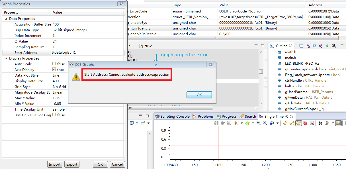

When I follow the example project "proj_lab01b" guide to add graph like this " Step 1. Click Tools->Graph->Dual time in CCS menu. Click the Import button and select the appropriate
single or dual time file from “..\sw\solutions\instaspin_foc\src\proj_lab01b_d1&d2_1.graphProp. " then click OK, the above error appear. after that, I resume the program. the graph windows value is always zero.

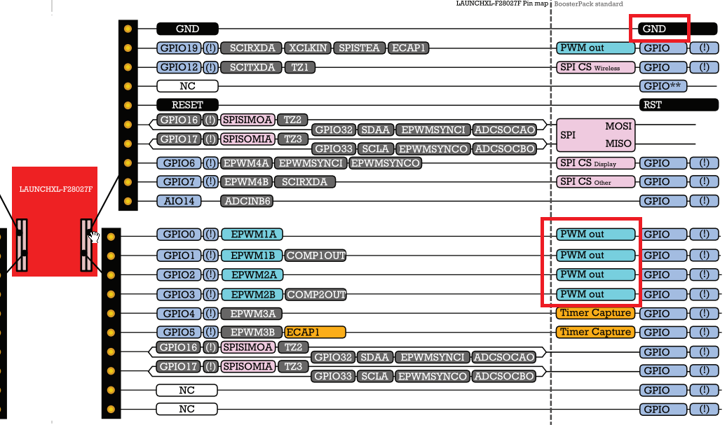

I also use the oscilloscope to check whether pwm wave have produced, but I follow the pin map below to measure votage between  PWMout  and GND, the value still is zero.
  • You are using F28027F which disable datalog for limited RAM memory, so you got such error message. You have to enable it and change the command file to use it if you wan to use it on F28027F.

    I forgot to power on the dc-bus on the drv8305, so it can not see the wave at that time. but now it is ok!  but the datalog function still doesn't work.

  • You can refer to F28069 project to change the .cmd file which enable the datalog in lab01b/lab01c in default mode. You have to decrease the datalog channels or buffer size for the F28027F does not have enough RAM memory.

  • Limit to RAM size, you have to decrease the length of dlog buff in datalog.h as below.
    //! \brief Defines the maximum buffer memory length
    #define DATA_LOG_BUFF_SIZE  300
    and change the .cmd as below if you didn't add any code in lab01b
       P_RAML0     : origin = 0x008000, length = 0x000880     /* on-chip PRAM block L0 */
       D_RAML0     : origin = 0x008880, length = 0x000780     /* on-chip DRAM block L0 */
