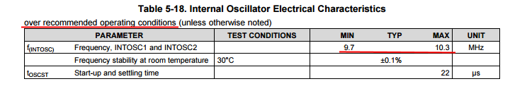

  • Hi Mir,
    The tolerance is specified here:
    Of the 3%, the supply voltage accounts for approximately 0.2% of the worst-case drift.  The rest is based on temperature.  This module does not have a linear temperature drift.  The worst case will be at -40C and the second worst case will be somewhere between 30C and the maximum rated temperature.
