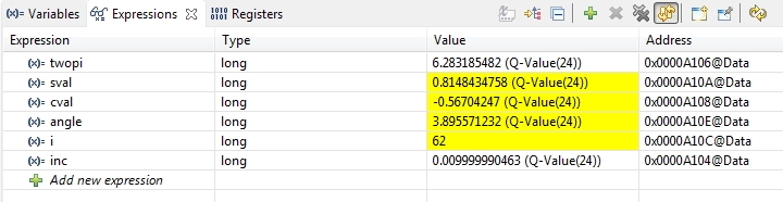

  • dear Richard
    First of all thanks for your time and help. I manage to fix the problem with the library by following your answer. Now i have a problem, I need to use the sine and cosine signal to compare with some float values in real time. I would like to know how to convert the values expressed below (Q format) to float directly(not only for visualization)
    I hope you can help me to fix this problem too. Maybe i need to do some conversion?
    And still i have some doubts about the results i have, as you can see in the next image, the values are not correctly at all for sine and cosine of the given angle. I would like to know if there is another thing i should add to the code? I'm here just using the code you sent to me. and I even add the #define   GLOBAL_Q       24
    Thanks in advance for your help
    Maria
  • Dear Richard,
    The problem with the 33 errors is generated when I try to include the library #include “IQmathCPP.h” that is used in the examples. I also tried to use the FastRTS but nothing seems to give me values that are useful for me for now. I imported the libraries:
    #include "math.h"
    #include "C28x_FPU_FastRTS.h"
    And not even with 0 or 2*pi or 180 i have some value that is close to reality. Hope you can help me
    best regards
    Maria

    and the replies i have are not the correct values, I don't know if I should change then some other configuration ?
    wp = 0;
    angle = 0;
    sinRT = -0.9569404
    cosRT = -0.2902847
    or in a second try
    wp = 2.65;
    angle = 16.65044;
    sinRT = 1.054673
    cosRT = 0.008753741
    Please I hope you can help me to understand where is the mistake
