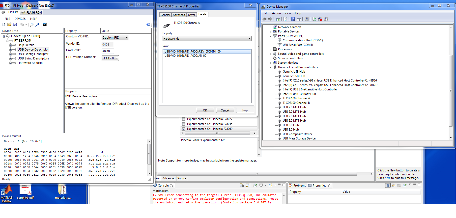

I got the new board and tried to connect it. But there is an error when connecting, as shown:
Error connecting to the target:
(Error -1135 @ 0x0)
The emulator reported an error. Confirm emulator configuration and connections, reset the emulator, and retry the operation.
(Emulation package 5.0.747.0)
And the .ccxml shows as follows.
