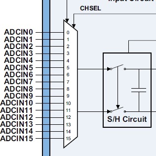

I would like to read a voltage ranges 0 to 3V in 0.075V intervals so I need to use ADC for this purpose, here are my questions about 379D ADCs:
1. How many ADC channel does F28379D have? Based on the datasheet, there are 16 ADC input:
But based on the schematic, there are 24 ADC input with different labels:
So I'm a little confused.

  • Hi Kash,
              The figure you quoted in item #1 refers to the ADC input mux on a single ADC module.  For each ADC module, there are 16 possible inputs or channels as depicted by the mux (ADCIN0 to ADCIN15) but in device implementation, not all the 16 inputs are physically connected to a device pin.  The F28379D device has 4 ADC modules, and ideally if all 16 input pins are implemented for all 4 ADCs there would have been 64 ADC channels total.  In the schematic above, ADC implementation on F28379D is as follows:
    - 6 channels are available for ADC module A (ADCA)
    - 6 channels are available for ADC module B (ADCB)
    - 4 channels are available for ADC module C (ADCC)
    - 6 channels are available for ADC module D (ADCD)
    - 2 channels are available that can connect to any of the 4 ADCs (referred to as common ADC channels)
    Hope this clarifies your confusion.
