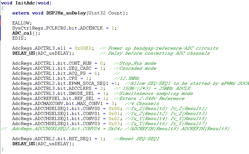

  • Modify some of the ADC initialization code ,The code they used before is as below:
      AdcRegs.ADCTRL3.all = 0xE0;
      DELAY_US(ADC_usDELAY);

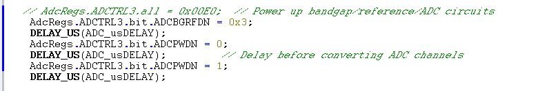

We modified the code as below,
       AdcRegs.ADCTRL3.bit.ADCBGRFDN = 0x3;
       DELAY_US(1000)
       AdcRegs.ADCTRL3.bit.ADCPWDN = 1;
       DELAY_US(1000);
  We founded that the longer of the delay time, the less times of the ADC problem.
My question is, what are the differences between the two different initialization methods?  I found that most examples in the ControlSUITE use the first way.
What are the requirements before the ADC initialization, for example, how long time we should wait before the initialization….

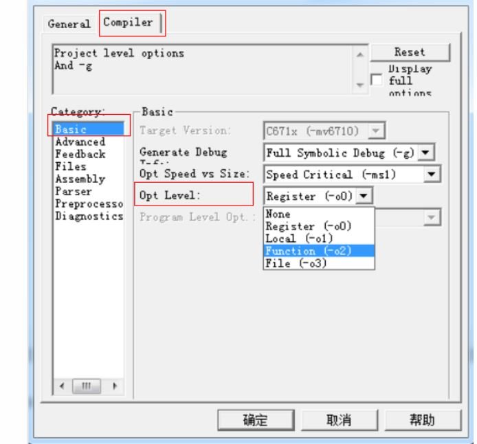

  • In the compiler Opt Level option, select different levels of optimization, we found that the times of the problem will change.
What is the difference between different Opt Level and how to choose the optimal level for the optimization?

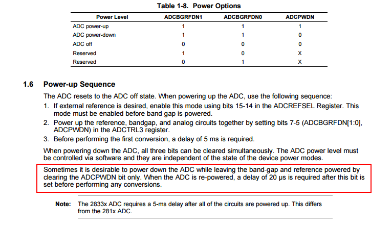

    The power up/down sequence is described in the ADC UG in section 1.6 "Power-up Sequence"
    You would normally power-up and power-down the ADC by setting / clearing all 3 bits at once as per your first method. In the second method, you are powering up the references and bandgaps first, then the ADC next. This shouldn't affect the total power-up time for you.
    If you had completely powered everything up, then shut just the ADC down (not the BG and references) then you can power the ADC up in 20us.
    As far as the delays/optimization, for correct operation, you must wait at least 5ms after full power up before using the ADC. It is possible that optimization level is reducing or eliminating this time. You can measure the execution time between any two points when debugging (in CPU cycles) using the profiler:

    Thanks for your help , we do a lot of test today, maybe we have found the cause of this problem : after the InitADC(), we read the value of the ADC Register ,found that the value of  “ADCTRL1 ADCTRL2  ADCTRL3” are all zero! The InitADC() failed to configure the ADC register!Below is the code they used:
    What are the possible reasons that cause the register configure failed?

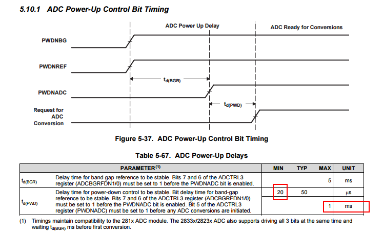

    And another test is as you have mentioned: “If you had completely powered everything up, then shut just the ADC down (not the BG and references) then you can power the ADC up in 20us.
    We use above code to power the ADC, found that this way can reduce the frequency of the problem. Have you ever encountered similar problems? Do you have any experience or basis for this proposal?
  • Hi Shuai,
    For the power-up time, the suggestion was directly taken from the module documentation:
    But based on the datasheet, you should still probably wait at least 1ms in this case and not 20us, as 20us is the best case power-up time.
