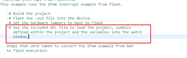

  • I may have to adjust the switches to boot to Flash, by putting s1 to ON-ON-OFF ?
    Also it mentions that I should use the GEL file to load the project? Can some one explain what this means and how i actually do that? These instructionsa rein the 28027 Flash example project.
    Thank you,
    Rajan Joshi
  • Hi Rajan,
    We do not recommend using the USB to power the device while erasing and programming the flash.
    Aditionally, you will need to configure the boot pins to boot to flash. Hopefully, this should resolve your issue.
    If you are using a target configuration file, then it is likely already using a GEL file. I do not think you have to worry about a GEL file.
