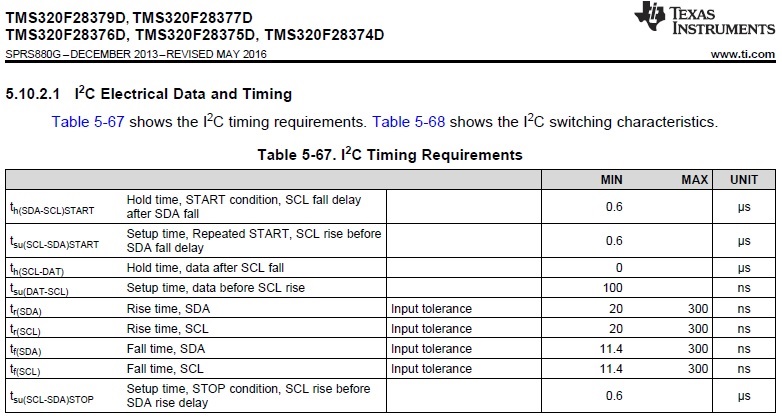

To be compliant with the SMBus specification customer need to know the TSU:DAT mentioned in "Figure 3-1: SMBus timing measurements" of www.smbus.org/specs/smbus20.pdf   Here mentioned as min 250ns.
1.Where can I find the related "Data setup time" value in the F28035 datasheet?
2.Is this timing requirement handled by the I2C hardware or has the software to manage this?
