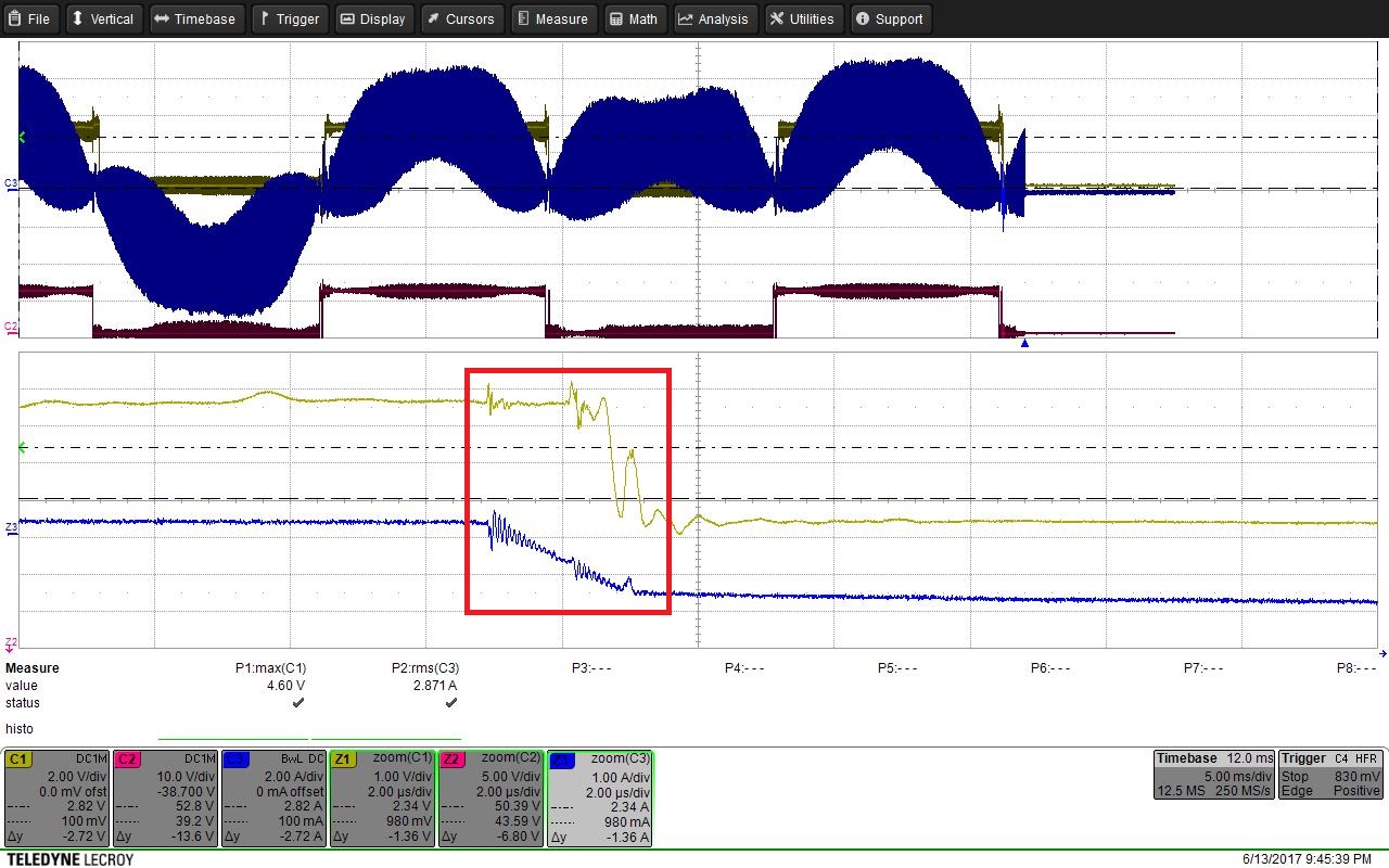

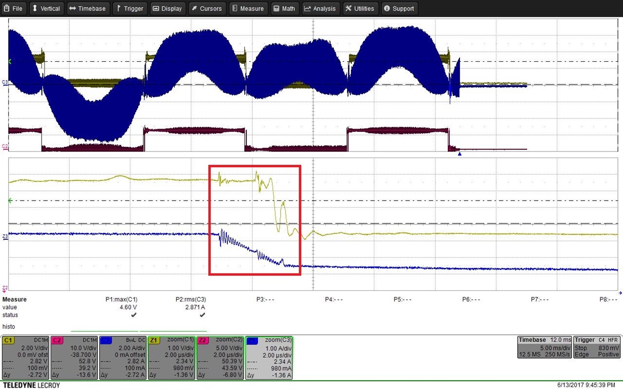

My customer using F28069 for the PFC control, in order to achieve the ZCD (Zero crossing detection), they using the GPIO as the ZCD signal and connected to ECAP pin.
However, in the power supply with the switching noisy we affect the capture result.
Does team had better idea to fix the problem? below are the code and the waveform.
thanks for your comment.
Ch1: ZCD Signal(connect to Capture pin);             Ch2: PWM;              Ch3: Inductor current.
