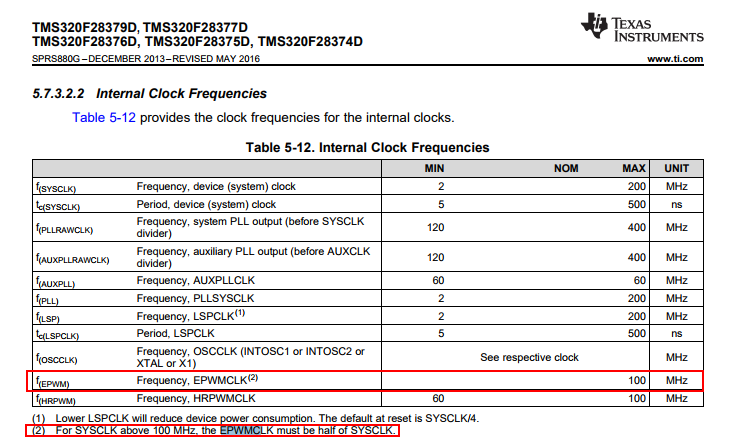

I am using TMS320F28377D and I am looking for some clarifications, for correcting my understanding of the EPWM clock. It would be great if you could help.
In my software I have set:
ClkCfgRegs.PERCLKDIVSEL.bit.EPWMCLKDIV = 0;
EPwm6Regs.TBCTL.bit.CLKDIV = 0;
EPwm6Regs.TBCTL.bit.HSPCLKDIV = 0;
so according to SPRUM8C, Fig. 13-5 pag. 1478
my ePWM TBCLK should be the system clock, i.e. TBCLK = 1/200MHZ = 5 x 10^-9 =5ns.
I am using EPWM6 in UP-DOWN mode, and I have setup
EPwm6Regs.TBPRD = 500;
so the PWM period is TPWM = 2 * TBPRD * TBCLK = 5 x 10^-6 = 5us (SPRUHM8C, pag. 1480), i.e. I am switching the converter at 200kHz, and I can see this from my actual setup. I assume that this means that my calculations above are correct.
The questions are:
(1)  Is there any limit on the TBLCK, i.e. am I using a TBCLK too low? (is there a 100MHz limit?)
(2) Also, I have noticed that:
ClkCfgRegs.SYSCLKDIVSEL.bit.PLLSYSCLKDIV = 1
 is this influencing my calculation above? Is the system clock still 200MHz? even with the above set  PLLSYSCLKDIV = 1?
Thank you for your kind help,
Leo

    The ePWM clock is indeed limited to 100MHz.  Setting it higher will cause unpredictable operation.
    There are a variety of valid ways to achieve the same SYSCLK setting using different clock sources, input clock frequencies, and PLL settings.  As long as these settings are valid, there shouldn't be any difference to downstream modules like the ePWM (except for obvious stuff like an input clock with worse frequency accuracy will result in reduced frequency accuracy for the downstream modules).  Some ways the clock source settings could be invalid would be too low or high of an input frequency to the PLL or too high or low of a PLL raw clock (the clock before the divider you quoted).

    Yeah, you should set ClkCfgRegs.PERCLKDIVSEL.bit.EPWMCLKDIV = 1. This will result in ePWM clock = SYSCLK / 2. If SYSCLK is 200MHz this will give you 100MHz ePWM clock. If you ran the CPU at 100MHz for some reason, you could instead set this bit to 0.
    As far as the PLL settings, see 2.7 "Clocking" in the TRM. Roughly, you have an input clock that is usually 10MHz-20MHz. This gets multiplied by the PLL to form the PLL raw clock, which is maybe 400MHz. Then this gets divided by the PLL divider to form the SYSCLK @ 200MHz. The divider you are referring to affects the PLL raw clock to SYSCLK ratio, which will affect the eventual ePWM clock (but also most other clocks on the device).

    Thank you very much, I got it. I attach the below picture from the TRM SPRUHM8e (pag. 106) for reference.
    Basically, in my setup the PLLRAWCLK is 400MHz, and by setting
    then the PLLSYSCLK is 200MHz.
    Now I must set
    ClkCfgRegs.PERCLKDIVSEL.bit.EPWMCLKDIV = 1;
    in order to have a EPWMCLK = PLLSYSCLK / 2 = 100MHz.
    All clear now, thank you.
