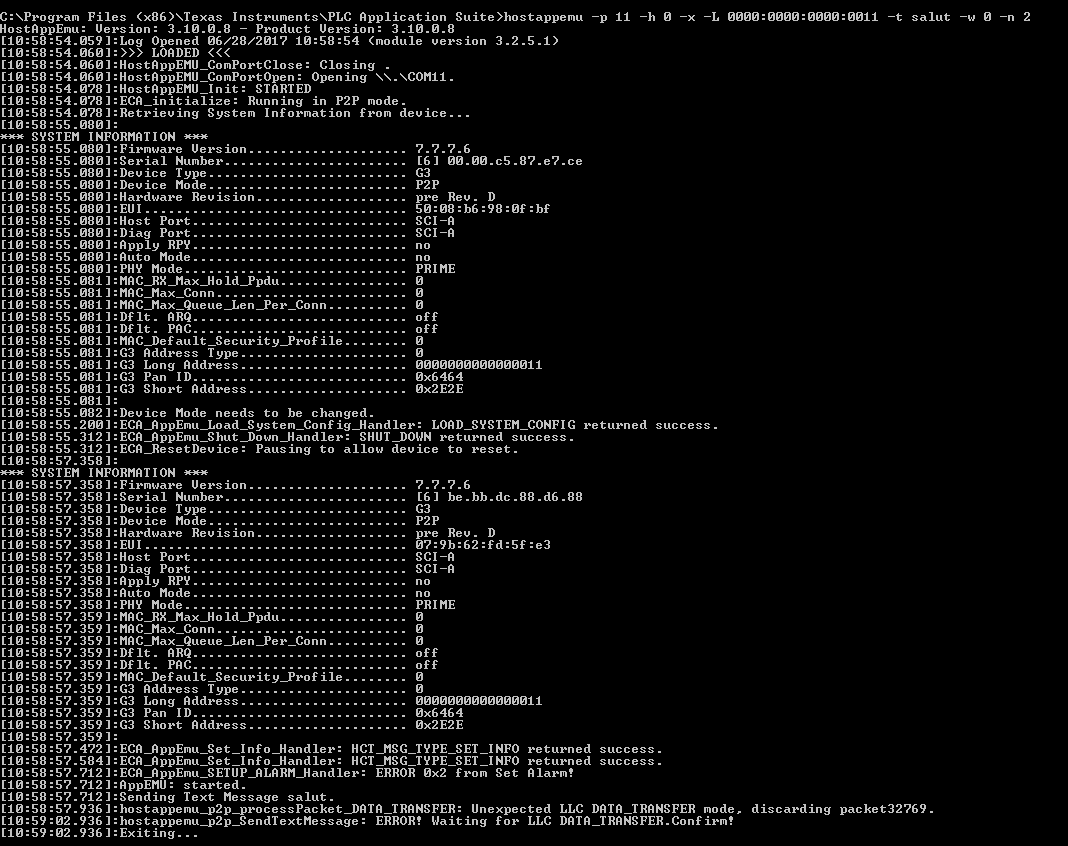

Hello community,

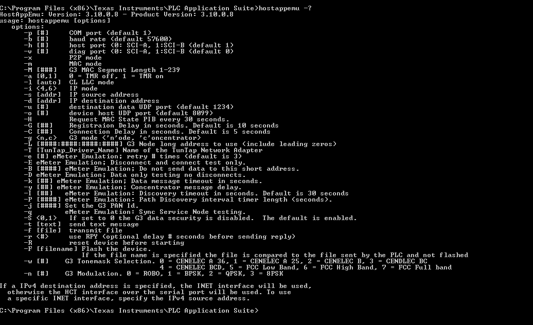

I am using the hostappemu.exe in the application suite to transfer files or text messages. I configure the parameters as shown in the help:
But when the command execution starts, it sets the physical mode to PRIME while I am working on G3, and it detects an unexpected "LLC DATA_TRANSFER_MODE". and so the file/ message transmission can not be executed
If you have any idea how to achieve this goal please share with me the relevant information you might have.
