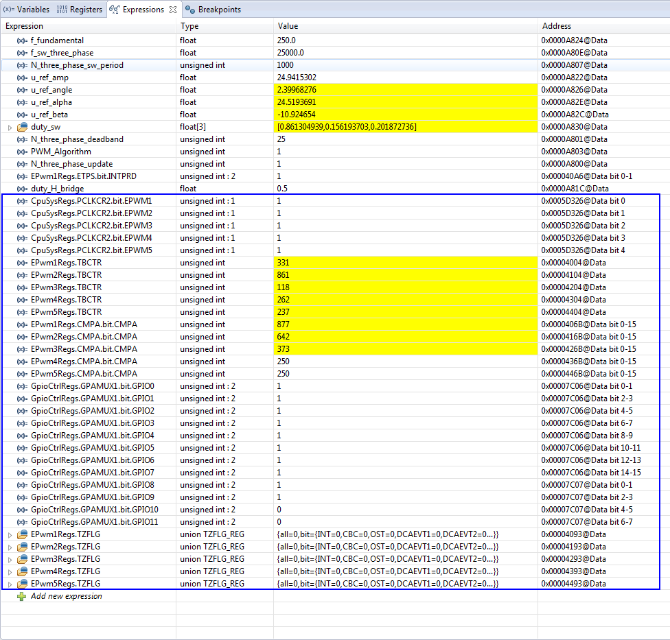

I have made a code to generate three-phase PWM and H-bridge PWM signals, below is my code.
The three-phase PWM signals (EPWM 1 - 3) should be synchronized with each other and the H-bridge PWM signals (EPWM 4 - 5) should be synchronized with each other.
The three-phase PWM signals have a fundamental of 250 Hz and a switching frequency of 25 kHz.
The H-bridge PWM signals use phase-shift control and have a switching frequency of 100 kHz.
Now I have three questions:
(1) If I understand the datasheet of TMS320F28379D correctly, the System clock is 200 MHz. And the datasheet of TMS320F28379D also says that: For SYSCLK above 100 MHz, the EPWMCLK must be half of SYSCLKOUT, which means if SYSCLKOUT = 200 MHz, then the EPWM clock should be 100 MHz. However, if I set both of TBCTL.bit.HSPCLKDIV and TBCTL.bit.CLKDIV as 1, then will the EPWM clock be forced to be 200 MHz?
In addition, in my code, I set both of TBCTL.bit.HSPCLKDIV and TBCTL.bit.CLKDIV as 1, and if the EPWM clock actually is 100 MHz, and since I need 25 kHz switching frequency, the EPWM Period Register should be set to 100 [MHz] / 25 [kHz] / 2 = 2000 (up-down counting mode). However, it gives a switching frequency of 12.5 kHz, so I have to set the EPWM Period Register to be 1000 in order to get 25 kHz switching frequency. This is confusing for me. Why is it like this?

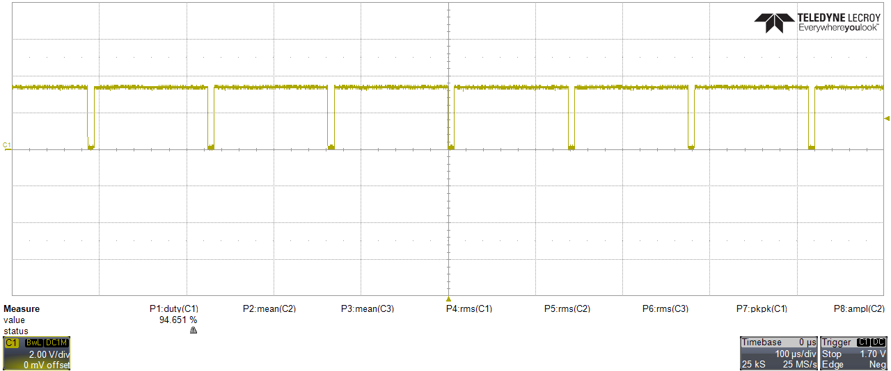

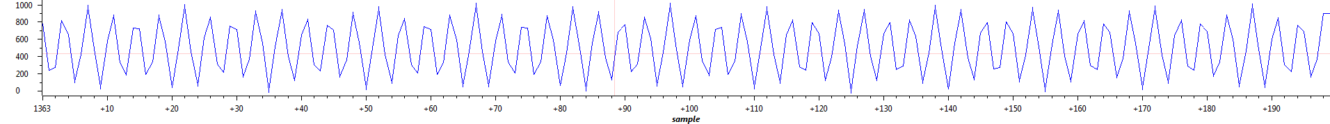

(2) I tried to update the three-phase duty-cycle in the EPWM1 ISR function generated at counter = zero. Every time the ISR function is called, a phase shift is added so that the voltage reference vector rotates at 250 Hz.
If I set EPwm1Regs.ETPS.bit.INTPRD = ET_3RD, which means to generate INT on every 3rd event, then the fundamental frequency is correct, 250 Hz, (every time the ISR is called, the voltage vector phase shift is 3 times than the previous correspondingly). However, if I decrease EPwm1Regs.ETPS.bit.INTPRD to ET_1ST, i.e. the interruption happens at each switching cycle, then the fundamental frequency becomes much lower.
However, if I keep EPwm1Regs.ETPS.bit.INTPRD to ET_1ST and decrease the switching frequency to 10 kHz, i.e. the interruption frequency also decreases to 10 kHz, then the fundamental becomes correct.
I thought that maybe this is because the interruption function is too time consuming for the DSP to process within one switching cycle so that some interruptions are lost in the meanwhile. However, I think the interruption function is not so long, and since the DSP works at 200 MHz and the interruption frequency is 25 kHz, which means 8000 calculation steps can be performed within one switching cycle, I think it should be far more than enough.
Any explanation and solution about this?

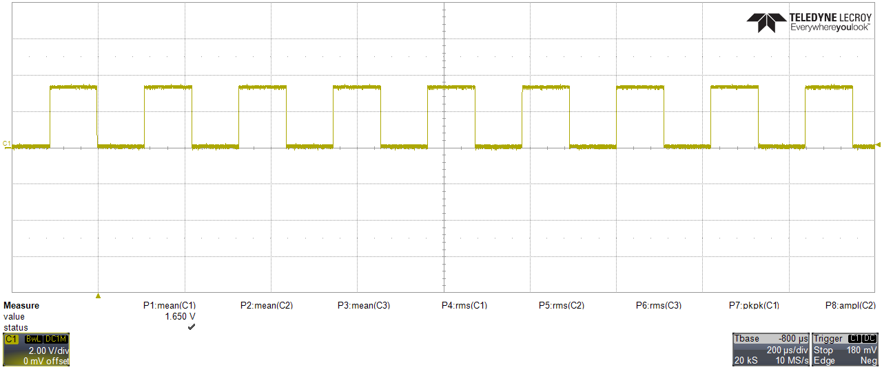

(3) The EPWM 4 and 5 are programmed based on the "TMS320x280x Enhanced Pulse Width Modulator (ePWM) Module Reference Guide (SPRU791)" Chapter 3.9 ZVSFB Converter. However, the EPWM4A and 5A are always giving 3.3 V whereas the EPWM4B and 5B are always giving 0 V. This is very confusing for me. Hope someone can explain to me.

N_three_phase_update = EPwm1Regs.ETPS.bit.INTPRD;
u_ref_angle = u_ref_angle + two_pi*f_fundamental/f_sw_three_phase * N_three_phase_update;

    (2) I set
    EPwm1Regs.ETPS.bit.INTPRD = ET_1ST
    and then toggle GPIO10 at the beginning of the ISR:
    if(k == 0)
        GPIO_WritePin(10,1);
        k = 1;
    else
        GPIO_WritePin(10,0);
        k = 0;
    And this is what I have got:
    It takes over 100 us to finish one ISR, which means it takes more than
    100 [us] * 100 [MHz] = 10000 SYSCLK
    to finish one ISR. This is incredible since my ISR is not complicated at all, simply a PWM duty cycle calculation code (I use a switch to choose one from the three PWM algorithms).
    I also set a break point at the beginning of the ISR function and plot the counter value when the CPU come across the break point. It seems that the ISR starts at any point of the counter value instead of EPwm1Regs.TBCTR == 0.
    Any explanation and any solution?

    For 2) Can you modify this slightly to toggle the GPIO at the start and end of the ISR? If I'm understanding correctly, you are toggling it at the start of each ISR so you are waiting a full PWM period until the next event. It should be

    (1) Here is my setting:
    EPwm1Regs.TBCTL.bit.HSPCLKDIV = TB_DIV1;
    EPwm1Regs.TBCTL.bit.CLKDIV    = TB_DIV1;
    I think this means both of them are divided by 1, right?
    (2) I have modified the toggling code and here it is the updated plot:
    It seems that 94.651% of the CPU time is in the ISR function.

    • Make sure the EPWM clocks are enabled (PCLKCRx)
    • Make sure the time base is counting. Add the TBCTR to the Expressions Window in CCS and run/halt the processor. Make sure the value is changing.
    • Check the GPIO registers in the Expressions Window. Specifically, make sure the GPxMUX register for the pins are configured correctly.
    • If all of these seem correct, check the TZFLG register in the EPWM to make sure no trip event has occurred.
    Kris

    • The registers are set:
    CpuSysRegs.PCLKCR2.bit.EPWM4 = 1;
    CpuSysRegs.PCLKCR2.bit.EPWM5 = 1;
    • I applied "continuous refresh" and I can see that both EPWM4 and EPWM5 are counting.
    • Mux of GPIO0-GPIO9 are set to 1.
    • TZFLG are all zero.
    And one more problem is detected: EPWM1, 2 and 3 should be synchronized, but now the TBCTL of EPWM1, 2 and 3 are not the same, which means they are not synchronized, right? In addition, TBCTL of EPWM4 and 5 should be shifted by 250, but it seems not the case, which is confusing for me as well.
    As you can see from my code, I used these settings to make them synchronized:
