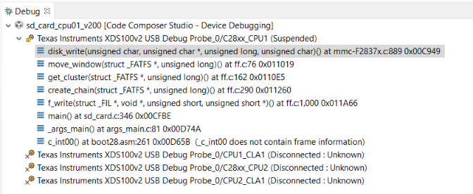

I tried to debug a lot and I have exhausted my knowledge. This is for the first time I am dealing with file system code and I am not a guru. I know C2000 documentation clearly mentions this:
The value written to the SIZE registers is one less than the intended size. So, to transfer three 16-bit words, the value 2 should be placed in the SIZE register.
Regardless of the state of the DATASIZE bit, the value specified in the SIZE registers are for 16-bit addresses. So, to transfer three 32-bit words, the value 5 should be placed in the SIZE register.
Regardless of the state of the DATASIZE bit, the value specified in the STEP registers are for 16-bit addresses. So, to increment one 32-bit address, a value of 2 should be placed in these registers.
I tried to play around with those settings along with the SpicRegs.SPICCR.bit.SPICHAR = 0x7 setting by making it 0xF which is equivalent to 16 bits. But nothing works yet when I try to debug with DMA option enabled. :(
I know DMA gets triggered as I can hit a Breakpoint in the ISR.
I really need your advice to make this work. I have speed and timing constraints and I need DMA feature for SD Card Data Logging to work. I appreciate your time!
