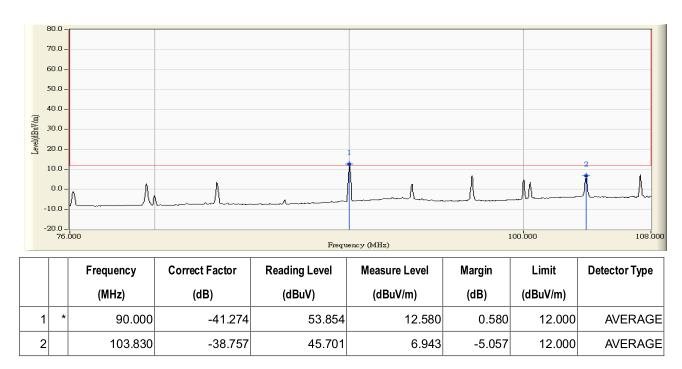

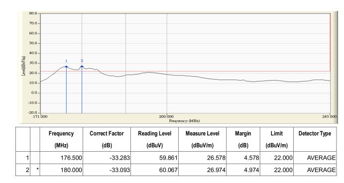

    Quasi-peak method detection is OK.
    The 90Mhz and 180 Mhz of peak method and average method detection are over limit.
    Let us get focus back how to solve 90Mhz and 180 Mhz EMI.
    90Mhz is system clock, 180MHz is PLL , system CLKOUT pin is disable.
    Any others ideas ?
    thanks,

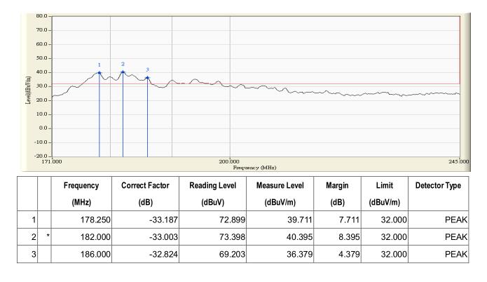

    below pictures are customer's board DEKRA report.
    best regards,
    Simen
