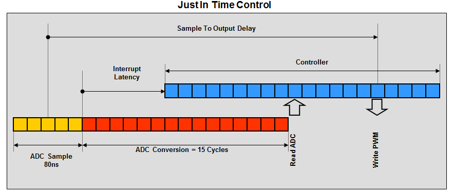

    1. On most of our families of devices (F2802x and newer), the ADC has Early Interrupt functionality.  When the ADC is configured in this mode, it means that the ADC will trigger an interrupt after it has completed sampling (but before it has started to convert).  This means that much of the conversion processes will occur as the CPU is changing contexts to the interrupt.  This can be one method of doing 'just in time' updates.  The picture below describes the idea.

  • Hi Howard,
    Just to add a couple more bits of info to add to Brett's answer:
    You can get the exact ISR context switch latency timings here (14 cycles for an internal interrupt):
    processors.wiki.ti.com/.../Interrupt_FAQ_for_C2000
    You can get the exact ADC timings out the F2837xD datasheet from Table 5-51. "ADC Timings in 12-Bit Mode (SYSCLK Cycles)" and Table 5-52. "ADC Timings in 16-Bit Mode".  There are also accompanying diagrams.  From this, you will notice that in the normal use case of SYSCLK = 200MHz and ADCCLK = 50MHz the timings are as follows:
    12-bit mode: early INT occurs at 1 cycle, results latch at 44 cycles.  Therefore if you use early interrupt mode you will need to wait or do setup operations for 44-1-14 = 29 cycles.
    16-bit mode: early INT occurs at 1 cycle, results latch at 120 cycles.  Therefore if you use early interrupt mode you will need to wait or do setup operations for 120-1-14 = 105 cycles.
     For both modes, if you use late interrupt mode, you arrive in the ISR 14 cycles after the results have latched.
