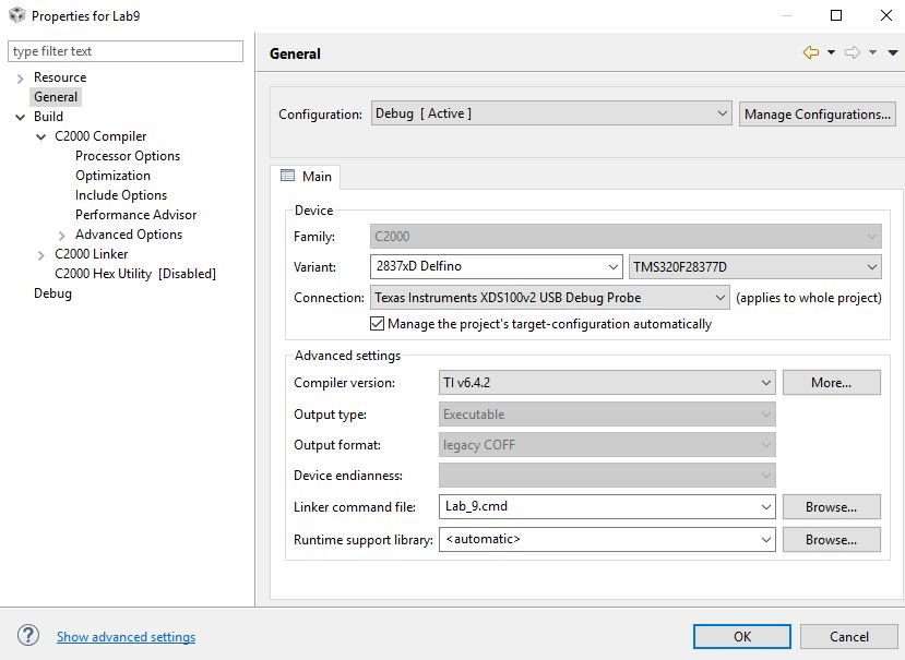

Moreover, this is the property window (I have used Lab_9.cmd in the "Linker command file" dropdown menu):
While this is the lists of files inside my project (is it correct to have both F2837xD_Headers_nonBIOS_cpu1.cmd and Lab_9.cmd ?):

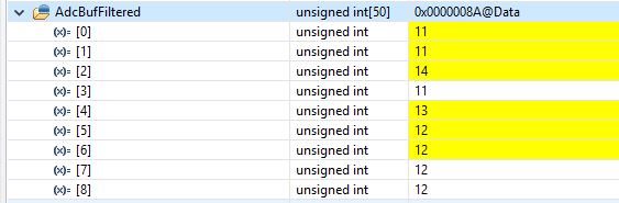

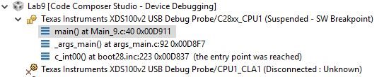

When I build and debug Lab9 project, it looks like the CLA1 is disconnected

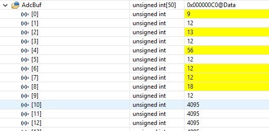

However, when I run the project, it looks like it is working, as the buffer AdcBufFiltered and AdcBuf keep updating:

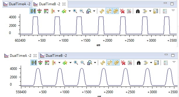

And the graphs also seem to display the results properly:
The question is whether the code modifications I have reported above are correct, i.e. have I modified the code as the exercise required? and also, is it correct that CPU1_CLA1 displays as 'disconnected' in the debug window?
