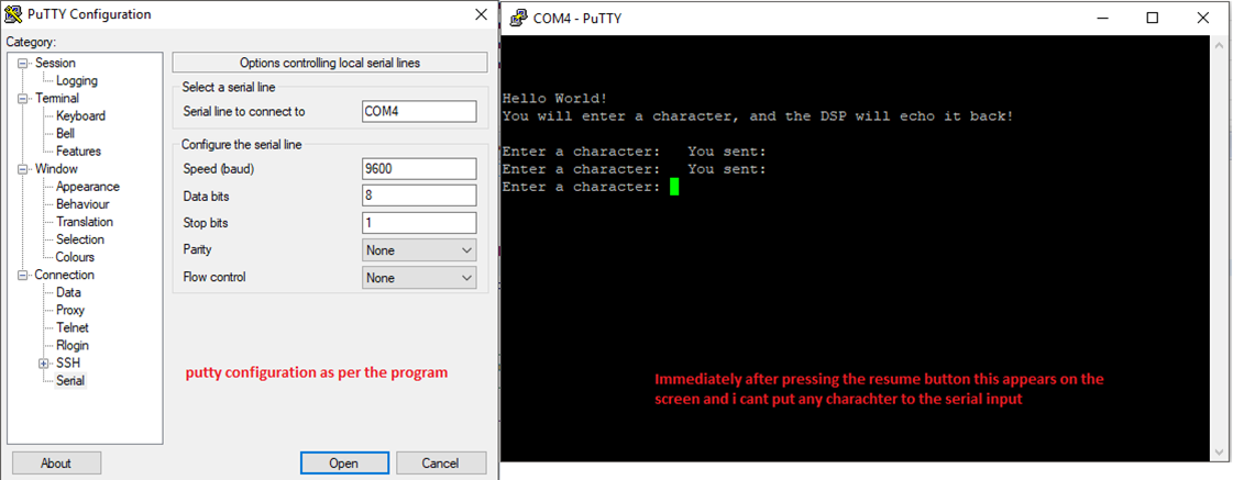

I have tried sci_echoback_cpu01 example and I am getting the following output.
As soon as the resume button is pressed, and program starts to run, the "Hello world" string and other messages appear on the putty or CCS terminal (whichever is set). And then I am not able to give any input to the system through the terminal to get the echoback.
Please see the attached below image.
