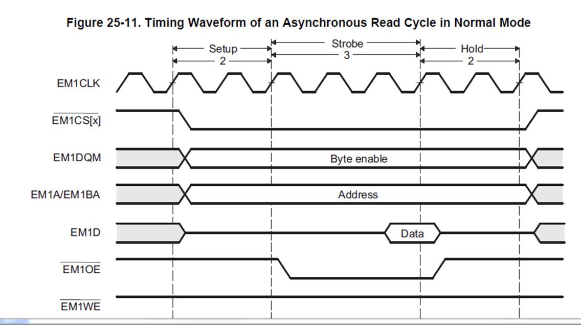

  • For an asynch read on CS4,  I see the timing diagram below.  Does this imply that the DSP always expect the read data to be valid 2 clk cycles after the EM1OE_n goes active low?  Does this hold always – even if the DSP software specifies the strobe time to be a value of 10?
  • The number below the Setup, Strobe, and Hold text indicates the times configured through software.
    So in the example that you pasted:
    Setup = 2 EM1CLK cycles (R_SETUP = 1)
    Strobe = 3 EM1CLK cycles (R_STROBE = 2 )
    Hold = 2 EM1CLK cycles (R_HOLD = 1)

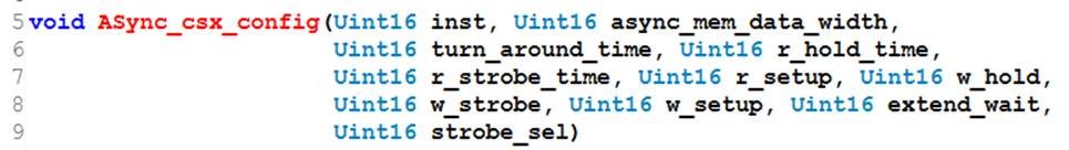

  • Our DSP software has the following settings for both async read and write:
    (0/8/1). ->
    Setup time = 1 emif clk
    Strobe time = 9 emif clks
    Hold time = 2 emif clks
    Then, per figure 25-11 is the Delfino expecting the data to be valid on the third clk cycle of the strobe period?
    Or is it expecting the read data to be valid on the 8th clock cycle of the strobe duration just before the EM1OE_n goes inactive?
    And am I correct in assuming that for our settings I don’t have to use the emif wait signal, em1wait? Can I just extend the strobe time to allow for any delay that the peripheral chip will have in driving the read data on the emif databus?
    FUNCTION PROTOTYPE TO UNDERSTAND THE PARAMETERS
    The number of cycles for each setting is configuration value + 1. If you have configured 2 for hold value then it'll be 3 cycle. Minimum hold is 1 cycle (programmed value 0) which is independent of strobe value.

  • I think there’s a misunderstanding in what I’m asking.  I understand about the +1 in the config reg.
    The item I’m not sure about is if the Delfino is expecting the read data to be valid 3 emif clock cycles after the falling edge of the em1oe_n signal.
  • EM1OE will transition at the start of the STROBE stage. EMIF will read the EM1D bus at R_STROBE+1 cycles after the start of the STROBE stage.
    So I suppose you could say that Delfino is expecting the read data to be valid R_STROBE+1 cycles after the falling edge of the EM1OE signal.
    Don't forget to factor in the setup and hold timings from the datasheets.
