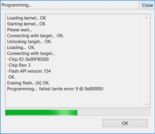

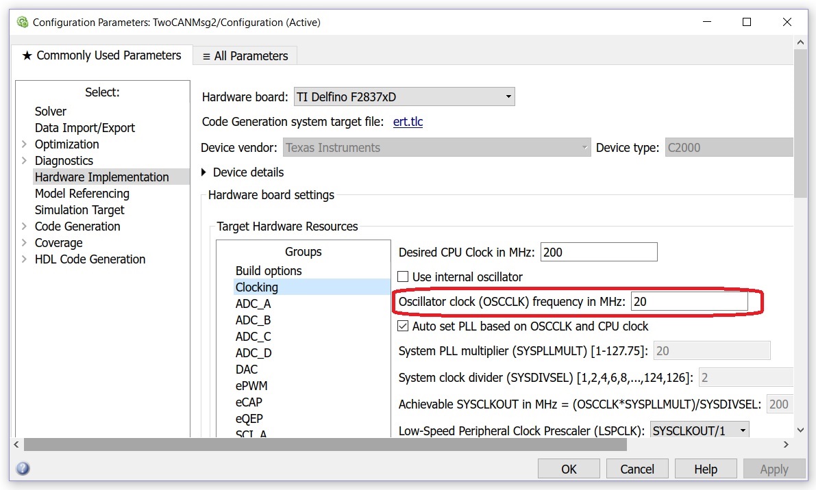

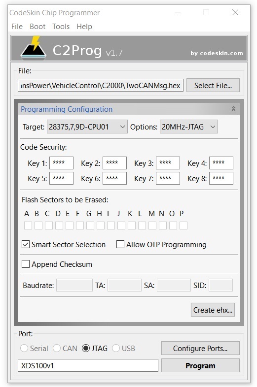

Which chip are you attempting to program and what is the external clock/crystal frequency? Is this a TI evaluation board or your own hardware?
Please post a screenshot of the C2Prog main window (with target configuration) and provide me with the full C2Prog version number (from "About" window).
