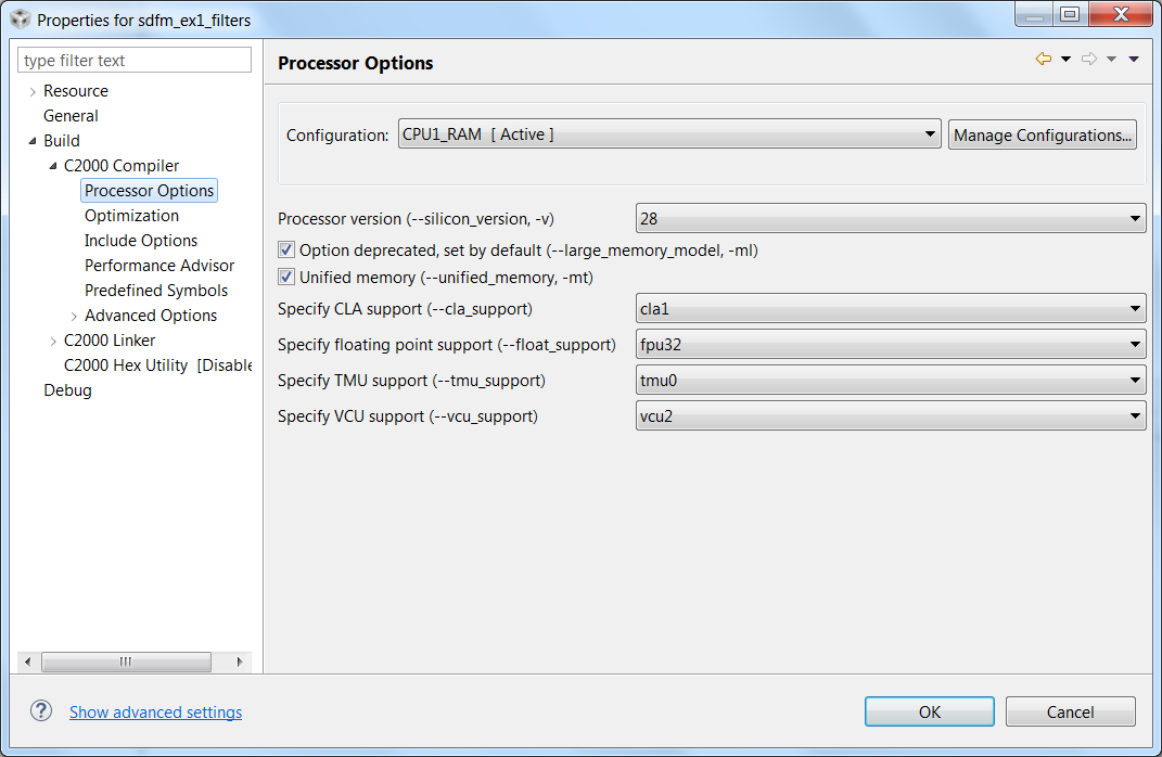

    I believe fp_mode needs to be set to "relaxed".
    Please set your project properties as shown below and try it out:
    I see 7 clock cycles for c = a/b; with this configuration.
    Hope this helps,
    Kevin
