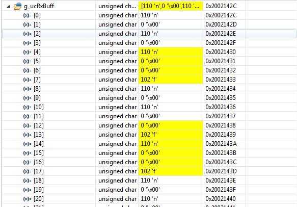

I'm writing a code to communicate through spi mode with a CC3200. F28379D is a slave while CC3200 is a master. So, the master work perfectly, infact it sending a string like this  "This is CC3200 SPI Master Application\n\r". The slave is not working as aspected.. I can send and receive only 2 chars. i want to send a data through spi in slave code but is impossibile with this setting.
I create a for cycle, but i thing that the problem is TXBUF, infact i can see that if i try to send more than 2 chars in the txbuf isnt more space to sending that. I tried to shift 8 space in register using <<8.. i tried to send 2 chars using | for connect the buffer space, but the result is the same. no more than 2 chars..
Another issue is a numbers of sending chars, for example, if i would to send 2 chars i can see that in spirxbuf of cc3200 there is a sequence like ABABABABABABABABABAB, until the buffer space of master is full.
Is there a solution for this 2 problems? Thanks a lot for the help.

Image of TXBUF of CC3200:
Image of RXBUFF CC3200 (Data coming from F28379D):
