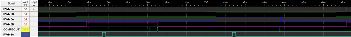

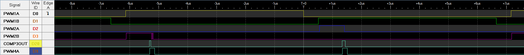

  • A little bit of continuation for this thread.
    So, I have an extra PMW (PWM4) configured for synchronizing the ramp start after dead band and blanking window. I'm using the following formula to calculate the needed phase value:
    EPwm4Regs.TBPHS.half.TBPHS = EPwm4Regs.TBPRD - (EPwm2Regs.DBRED + BLANKING_WINDOW) + 3;
    +3 is needed to make sure the ramp starts before the blanking window ends. If the ramp starts late then the leftover of the ramp will trip next pulse at beginning. This can cause some random short pulses when we should have max width pulses constantly.
    Also, I had to set QUALSEL = 1 (SYNCSEL = 0) for the comparator because otherwise I could see a case where the comparator had triggered, but the output pulse was so short (observed from COMP3OUT) that it would not trigger a trip zone, but COMPSTS would still trigger the Ramp generator reset logic. Resetting the ramp causes it to stay at RAMPMAXREF for rest of period and would allow current to rise higher than it should. This is seen as rapid changes in the pulse width.
    After these settings everything seemed to be ok, until...
    As I'm using nonqualified comparator output (SYNCSEL = 0) for the trip zone logic I'm seeing some glitches in tripped pwm falling edge as described here:
    e2e.ti.com/.../2052360
    We decided to use larger QUALSEL to clean up these. But if I try to set QUALSEL > 1 and SYNCSEL = 1 the comparator output gets delayed and it can reach over after the blanking window and trigger trip zone early on the next pulse. I'm back at the original problem that some noise spike during blanking window may trip the next pulse early and cause a random short pulse. This time increasing TBPHS doesn't help.
    I'm out of ideas what to try next. It seems that I'm constantly forced to find various workarounds and struggling to get multiple HW features working at the same time. Am I doing something strange with my setup here?
    -Pauli

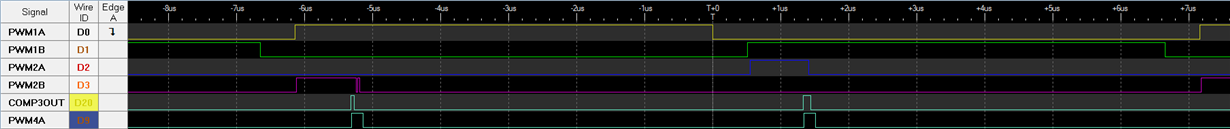

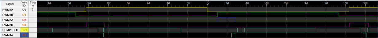

  • Thank you for your reply.
    I'm not sure what causes the tripping. All I know is that we are seeing some unexpected changes in the PWM width in the actual application. Usually a single extremely long or short pulse compared to others. I'm testing this on a docking station with just a variable power supply or some other simple means as the peak current signal. I'm trying to make sure there are no edge cases that could cause a false tripping or that the trip doesn't happen at all or comes late.
    I've found that if the ramp reset position is too late (after blanking window end) the ramp continues into next half cycle and then a low peak current can trigger trip zone too early. And if ramp reset is too early then a trip during blanking window resets the ramp and causes the real current to reach RAMPMAXREF late. I'm trying to make sure none of these cases are possible to happen.
    I understand that my test setup may not be totally realistic, but it's hard to test otherwise. Any ideas how to test and make sure that the trip zone, blanking window, ramp generator and all are working correctly are welcome? Now it is very laborious and the system seems to break easily. Confidence in the system isn't very high.
    Anyway, I found that moving the ramp reset a bit earlier by increasing TBPHS does help after all. Now I'm using:
    EPwm4Regs.TBPHS.half.TBPHS = EPwm4Regs.TBPRD - (EPwm2Regs.DBRED + BLANKING_WINDOW) + 10;
    When I increase QUALSEL to 4 and enable SYNCSEL I see that the COMP3OUT signal gets delayed and also wider. Then there's the additional delay from COMP3OUT to actually triggering the trip. So, with all these delays, the ramp reset needs to be quite a lot before the blanking window ends. Otherwise the trip will happen at the start of the next PWM cycle.
    This is ok, I guess. But if the reset gets too early (with a shorter blanking window for example) then I'm back with the problem of the ramp resetting during blanking window.
    There's still something strange happening on the comparator output when the peak current level is close to the RAMPMAXREF value, but fortunately the tripped pulse is ok.
    -Pauli
