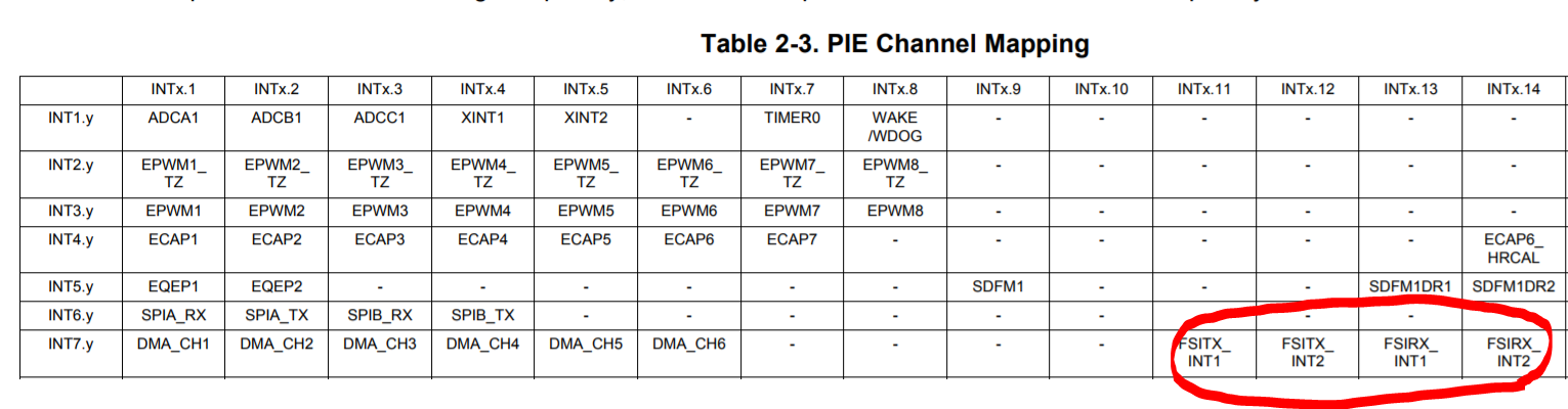

In the technical reference manual for F24004x processor, PIE channel mapping table the interrupts INT7.11, INT7.12, INT7.13 and INT7.14 are allocated to FSITX_INT1, FSIRX_INT1, FSITX_INT2 and FSIRX_INT2 respectively but in the f28004x_pievect.h file, PIE_VECT_TABLE struct definition it is allocated with only reserved as below

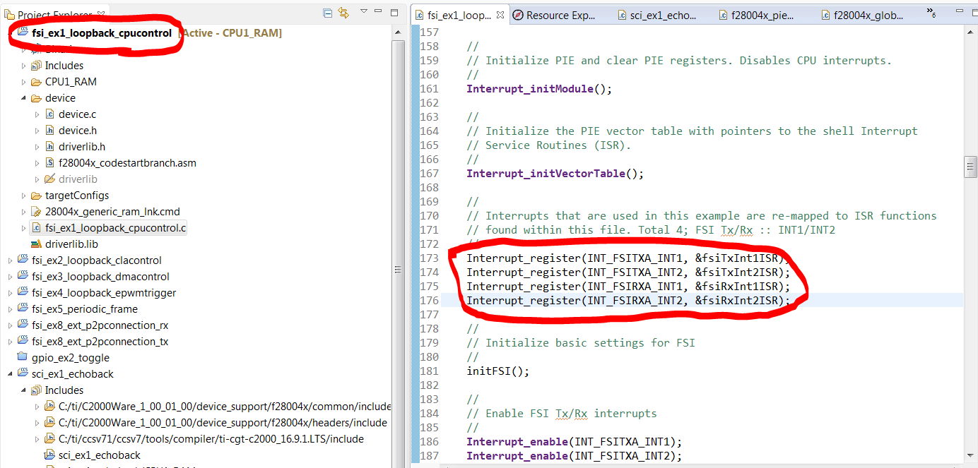

  • Aditya, I looked through the documentation and the code and here is what I found.
    If you look at the TRM as you mentioned you will see the
    which clearly states what you are saying.
    Looking in the Bitfield examples, which still do not have the FSI examples, you will find,
    But that does't mean they are not there. They just have not been named correctly in code. They will be updated.
    In the meanwhile for confirmation if you look at the driverlib example you will see these interrupts being used by FSI.
    At this time if you like to use bitfields you need to access the correct part of the pie vect.
    Below shows what the 7.11-7.14 are named,
    To do bitfield FSI please try
       PieVectTable.PIE80_RESERVED_INT = &yourISR; //7.11
