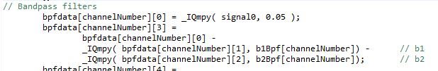

I have a sw state machine that is currently running within Timer1 interrupt:
interrupt void cpu_timer1_isr(void)
CpuTimer1.InterruptCount++;
GpioDataRegs.GPASET.bit.GPIO9 = 1;
GpioDataRegs.GPACLEAR.bit.GPIO9 = 1;
cntOutputsHigh = 0;
cntOutputsHigh += GpioDataRegs.GPADAT.bit.GPIO2;
cntOutputsHigh += GpioDataRegs.GPADAT.bit.GPIO4;
cntOutputsHigh += GpioDataRegs.GPADAT.bit.GPIO30;
cntOutputsHigh += GpioDataRegs.GPADAT.bit.GPIO31;
if(cntOutputsHigh != oldCntOutputsHigh) {
oldCntOutputsHigh = cntOutputsHigh;
switch(cntOutputsHigh){
case 0:
GpioDataRegs.GPASET.bit.GPIO5 = 1; // Take 1x bit low (J1-3)
GpioDataRegs.GPASET.bit.GPIO8 = 1; // Take 2x bit low (J1-12)
GpioDataRegs.GPASET.bit.GPIO25 = 1; // Take 3x bit low (J1-6)
GpioDataRegs.GPBSET.bit.GPIO39 = 1; // Take 4x bit low (J1-14)
break;
case 1:
GpioDataRegs.GPACLEAR.bit.GPIO5 = 1; // Take 1x bit high (J1-3)
break;
case 2:
// GpioDataRegs.GPASET.bit.GPIO5 = 1; // Take 1x bit low (J1-3)
GpioDataRegs.GPACLEAR.bit.GPIO8 = 1; // Take 2x bit high (J1-12)
break;
case 3:
// GpioDataRegs.GPASET.bit.GPIO8 = 1; // Take 2x bit low (J1-12)
GpioDataRegs.GPACLEAR.bit.GPIO25 = 1; // Take 3x bit high (J1-6)
break;
case 4:
// GpioDataRegs.GPASET.bit.GPIO25 = 1; // Take 3x bit low (J1-6)
GpioDataRegs.GPBCLEAR.bit.GPIO39 = 1; // Take 4x bit high (J1-14)
break;
default:
break;
The logic is working fine, the problem is that the interrupt timing is inconsistent.
Here's the init code:
ConfigCpuTimer(&CpuTimer1, 86, 1); //
Using gpio9, I see the following using a data acquisition system:
So, there are about 12 set/clears in this 500us window, and they are disbursed randomly through time.
I suspect other interrupts are taking precedence over my state machine routine embedded in the timer1 isr. That would explain the varying period.
I see in the manual (SPRS698D) a reference that looks promising:
Should I reconfigure my timers to use timer0 as the interrupt source for my state machine?
Any other ideas or suggestions?
Thanks in advance for your valuable input!
