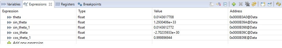

But the sin_theta and cos_theta are not right derived from sincos() function. (compared with sinf() and cosf() results)

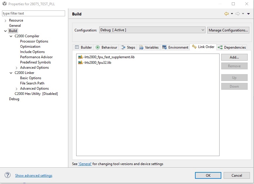

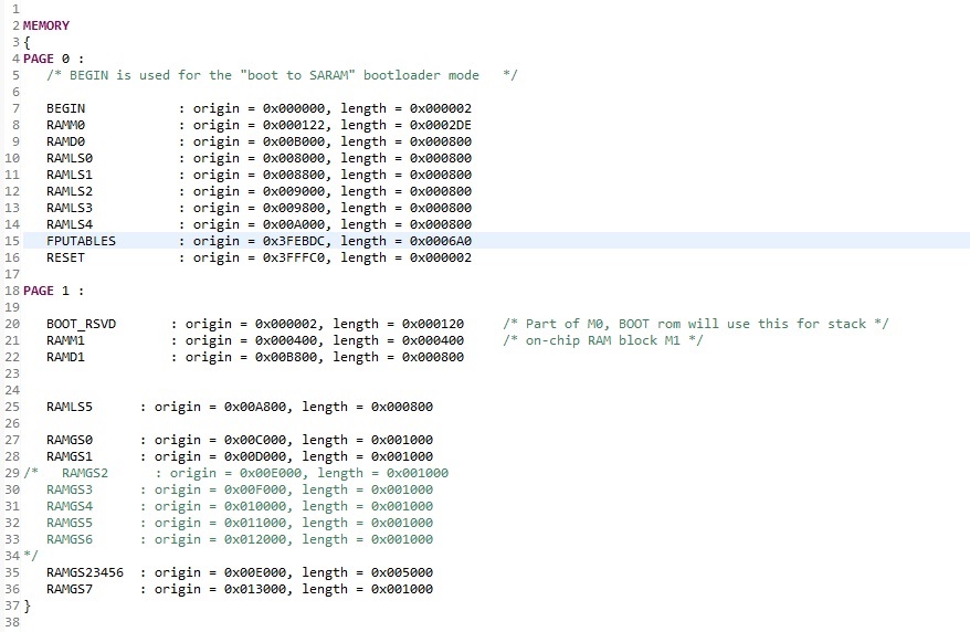

Following is my CMD file and settings related with fastRTS library.
The attached file is my project file. Could you please help me to find out what is wrong? Thank you in advance!

  • Thank you for your reply!
    the sinf() and cosf() is in math.h. Here I just use these functions to do the comparison.
    I checked the fastRTS instruction, for 2833x, the FPUTABLES is located in the Boot ROM. But in 28075 cmd file, there is no such section, and I added it by myself. I guess, the section can be added, but there is no table in it. Maybe this is the reason why my sincos() function does not work right. Do you know any method to use the fastRTS library in 28075? How can I load the table to my MCU?
  • Oh wow..
    F28075 has TMU and you do not need fast RTS for the sin and cos function, and other functions that are supported in TMU. Therefore we do not add FPUTables in the CMD file. Using TMU is the fastest way to do trig operations on C2000 MCU.
    Enable TMU and use optimization and select floating point as relaxes and the TMU will kick in automatically, or alternatively you can use intrinsics
