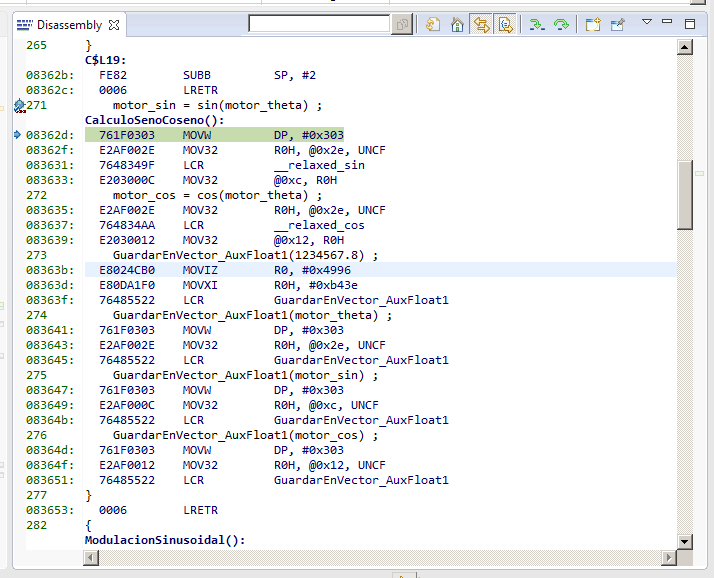

    The disassembly view:
    The corresponding assembler from the .lst file:

  • Have you placed a breakpoint in your function and read the motor_sin and motor_cos values in the Expressions window in CCS? Do they appear to be calculated correctly when you do that or are they off also incorrect like in your graph?
    Whitney
  • ...I see now, I think the values are correct. I believe I was misinterpreting the information shown by CodeComponerStudio. When I place a breakpoint or suspend the execution of the program, the values I collect in my code, or that I see in the Expressions table in CCS, are fine and correspond to the true values of SIN and COS functions. But when I stop refreshing the variables (but the program keeps running), the values shown are -I guess- from different moments in time, so they seem wrong, since they don't match the value of the argument given by CCS at that moment.
    I understand that all the values can not be show in real time, at least for values updating at kilohertz rates. Now it seems very obvious, and I feel a little silly, but at that time I was assuming it worked that way...
