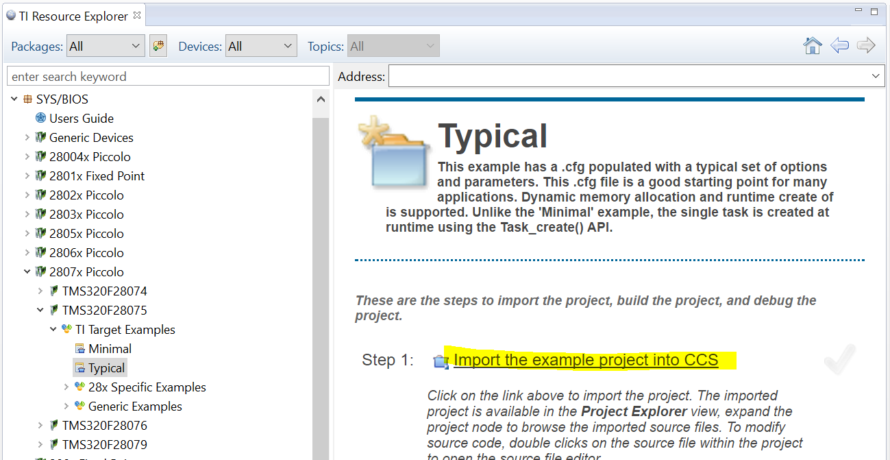

    I have downloaded the latest SYS/BIOS and XDC for the F28075 and ccs v7. Then from ccs v7, I create a new CCS project, and select the 28075 processor. Then I select a Typical SYS/BIOS template. But then when I click on Finish in the dialog box, it says there is a problem with the path 'resources/c28/include/tms320F28075.cmd'.
    Do you have any pdf file that shows how to create a sample SYS/BIOS project in ccs v7 for this processor?
  • Something smells fishy. Did you install SYS/BIOS in c:\ti? Did CCS locate it and ask you to restart?  Can you try using Resource Explorer and select a kernel example that way and see if it builds properly. For example
