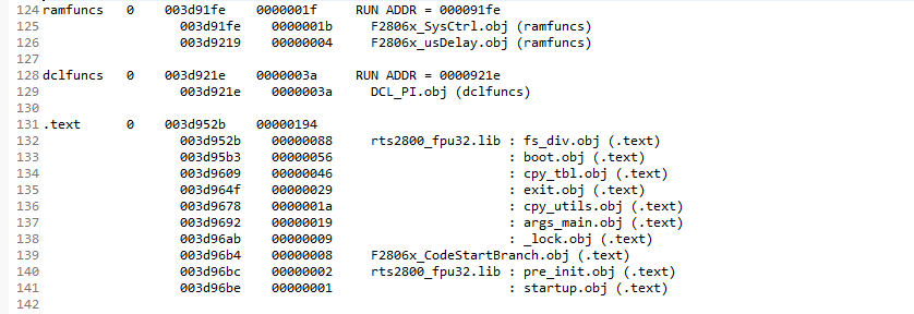

  • Thanks Mitja for your hint, actually I solved my issue in my own way, as you've mentioned before I realized that the critical function/library section of "rts2800_fpu32.lib : fs_div.obj (.text)" is still remaining inside the Flash, so I moved it to RAM using following technique and all the problems disappeared , Now I can say that it seems I'm having a very very close performance between Flash and RAM. ( I leave the steps here for the other people which I'm 100% sure that they will end up in the same problem sooner or later)
    so the way was firstly modifying the CMD file like below:
    Then in the following in .map file you can see the difference:
    Before adding  "rts2800_fpu32.lib<fs_div.obj>(.text)" in the ramfuncs section:
    After:
    so as you can see after modifying the .cmd file the specific library from .text section(which runs from Flash) was moved to ramfuncs ( which will be copied to RAM). I've also attached my .cmd file for those who want to have a look and might need to use the ideas inside.
    Thanks again.

        	.TI.ramfunc
        	ramfuncs{
        	dclfuncs
        }    LOAD = FLASH,
             RUN = RAM,
             PAGE = 0,
             TABLE(BINIT)
       .binit : palign=0x8, fill=0xffff > FLASH

       /* .reset is a standard section used by the compiler.  It contains the */
       /* the address of the start of _c_int00 for C Code.   /*
       /* When using the boot ROM this section and the CPU vector */
       /* table is not needed.  Thus the default type is set here to  */
       /* DSECT  */
       .reset              : > RESET,      PAGE = 0, TYPE = DSECT
       vectors             : > VECTORS,    PAGE = 0, TYPE = DSECT
    // End of file.
  • Glad you were able to resolve the problem and appreciate you posting the detailed solution.
  • I really recommend against using --ramfunc. Using it you move the linker settings from .cmd file and .c file, where it should be to the makefile if you have one or to CCS project settings.
    The only usage would be when you are building libraries
