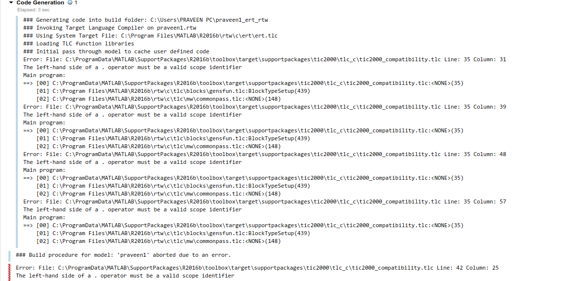

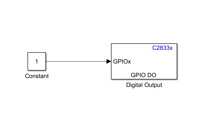

i need to blink the led for  every 0.5sec.Actuvally i started with basic program (blinking of led).My professor wants to use this in my project to produce the pulses for inverter.I tried in so many ways.But every time i was showing some errors.This program have been trying for 10 days.But no result yet.I am using embedded coder c2000 package in my matlab 2016b ver and ccsv6.In youtube videos they did with ccsv4/5.but it is not same in ccsv6.Some one could you kindly help me on this.Even mathworks also not responding.So your help is needed.

    Form the error message, I cant tell exactly what the issue is. My guess is that the C2000 Support package is not configured correctly - and the code generator cant find the files it needs to build and compile.
    You can type targetupdater at the MATLAB Command line, to walk-through the setup - make sure you select CCSv6, and carefully read the screens - you need to carefully tell the MathWorks code generation tools where your various TI files exist on your machine.

    one guy replied like this ""If you see the error, it says there is something wrong with the corresponding tlc file of the Digital Output block. Either you can open the tlc file and see the line where the error occurs and try to fix it, or you can redownload the Simulink Library for the C2000 package. But I suggest you to open tic2000_compatibility.tlc file in the specified folder and check the mistaken line of code."".
    how to interpret matlab inbuilt code.I am not getting.
  • No need to call them.I got the reply recently before you replied to this.But he told something like below regarding to the error.
