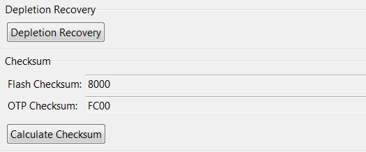

The checksum of failure device is as follows. Looks the device is never programmed.
Would you kindly help to comment the root cause of the failure?

Young,
Are you sure these parts weren't erased / programmed before? The parts you receive from TI shouldn't be depleted.
Where did you get these parts from?
-Manoj
Young,
I don't get what you mean by "new fabricated PCBA". I just want to know whether this is virgin part received as it is from TI (or) was the part ever erased / programmed?
Manoj
