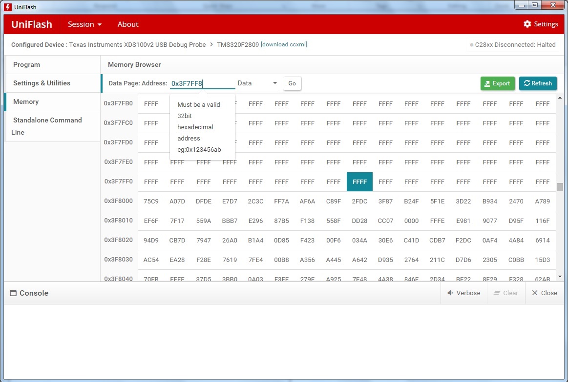

    Did you already try updating CCS? I'm wondering whether this is CCS issue (or) some sort of board issue
    Also, did you check the contents of CSM password location 0x3F7FF8 – 0x3F7FFF? I'm wondering whether these locations all read 0x0000s.
    Can you send me a snapshot of memory browser reading these locations?
    Manoj
    I checked the contents of CSM password location 0x3F7FF8 – 0x3F7FFF.
    Please find snapshot of memory browser.
    Sanjay
  • Sanjay,
    Okay. It is clear that CSM is unlocked.
    Can you try updating CCS and retry.
    Manoj
