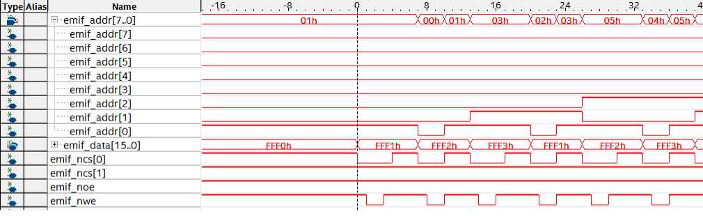

I am using EMIF in 16-bit async mode.  Per the technical manual, A0 is connected to EM1BA1, A1 to EM1A0, and so on. The EMIF1 is configured as follows:

Please see the attached file for EMIF bus signals.  The address bus signals are expanded.  The EM1BA1 bus line (least significant address line in 16-bit mode), toggles in reverse.  See the bit patter for 3 least significant bits:
Address written   Address on Bus
000                           001
001                           000
010                           011
011                            010 etc.
Also, only EM1BA1 reverts to logic high when CS becomes inactive.  All other address bus lines stay in their previous states.

    Can you elaborate on your concerns? The datasheet timing diagrams specify when asynchronous signals are valid relative to the WE and OE signals.

    Yes, BA1 should not change like that. Have you double checked the pinmux setting for the BA1 (GPIO92) signal to make sure it is configured correctly? Other thing  to verify is the connection on board.
    Also check the value of ASYNC_CS2_CR register in register view after configuration to make sure it is configured properly.

  • Thanks Vivek for the reply.  I had connected incorrect signal to A0 (instead of EM1BA1 I connected EM1DQM2 which happens to toggle exactly opposite of EM1BA1!!).  With EM1BA1 connected to A0, the issue is resolved.
