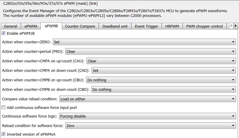

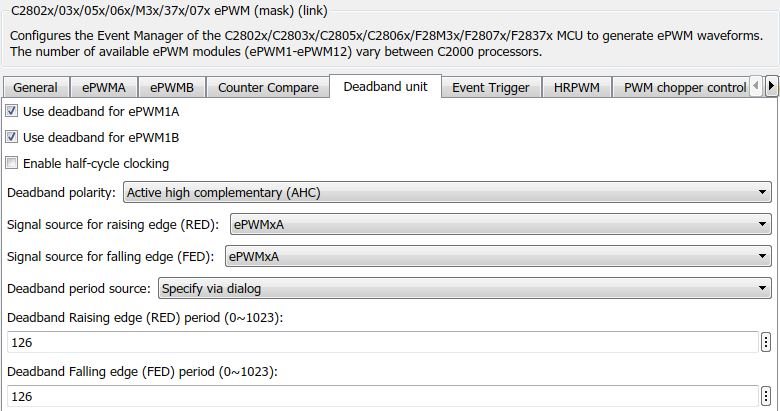

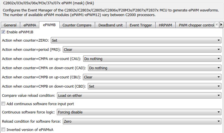

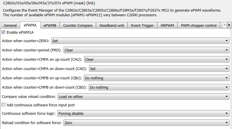

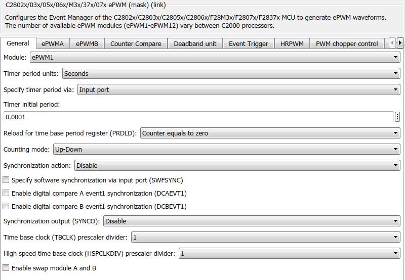

Hi all! ;)
I have now finished the hardware work to build my own three-phase inverter for motor control. The inverter shall be run by my F28069M-LaunchPad. To avoid a shoot-through in the IGBT-module (B6 bridge topology) I wanted to insert a dead time between the falling edge and the next rising edge. I wanted the dead time to be 1.4 µs which is about 126 clock cycles on my 90 MHz MCU.
I found post here on the E2E forums that describes all the necessary steps to set such a dead time in the "Deadband unit" tab in Simulink:
https://e2e.ti.com/support/microcontrollers/c2000/f/171/p/152067/551099#551099
However, I set everything just like mentioned in this post but my oscilloscope shows that there is no deadband inserted between the falling edge of one switch and the rising edge of the other switch. Or let's better put it this way: The deadband of 1.4 µs is indeed inserted, but not only the rising edge is delayed, also the falling edge is delayed. (I found this out because at 10 % duty cycle the ePWM1A signal is constantly low and the ePWM1B signal is constantly high.) This should not happen. The falling edge should occur immediately and only the rising edge should be delayed.
Do you know what I did wrong here? I will attach some screenshots of my configuration below.

  • Hi Chen,
    I attached the generated code below (only the part that refers to the setup of the deadband unit, if I should upload more, just tell me).
    Do you see anything wrong at first sight? Can I find a detailed documentation of all the registers and settings that are mentioned in the C code in the Technical Reference Manual of the MCU (chapter about ePWM)?
    Armin

  • Hi Armin,
    Could you please un-check the option "Inverted version of ePWMxA" from fig.3.
    The option of "Active High complementary" in fig.4 would do the inversion anyways.
    Please let us know if this works for you.
    Venkatesh C
  • Hi Venkatesh,
    Thank you very much! That was the reason why it did not work. I did not know that the deadband unit inverts the input signal, too.
    Everything is now working how I wanted it to. If anyone has the same problems in the future, I will attach screenshots of my working setup to this post.
    Armin
