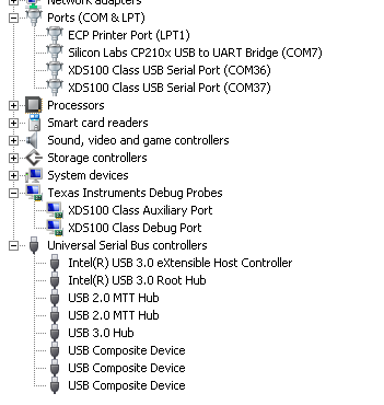

We have a custom board and custom debugger with FTDI chip FT2232 which was working good. suddenly debugging stopped working  in my PC
we could able to debug same system  from the different  PC, but not from my PC. I have removed all drivers and uninstalled and
reinstalled the CCS and drivers again but facing the same issue.
I could not identify the issue .
I have attached the port detected and LOG from the debugger
Please help me understand the issue and solve it .
kamaraj
please refer below the error message i got from the debugger .
