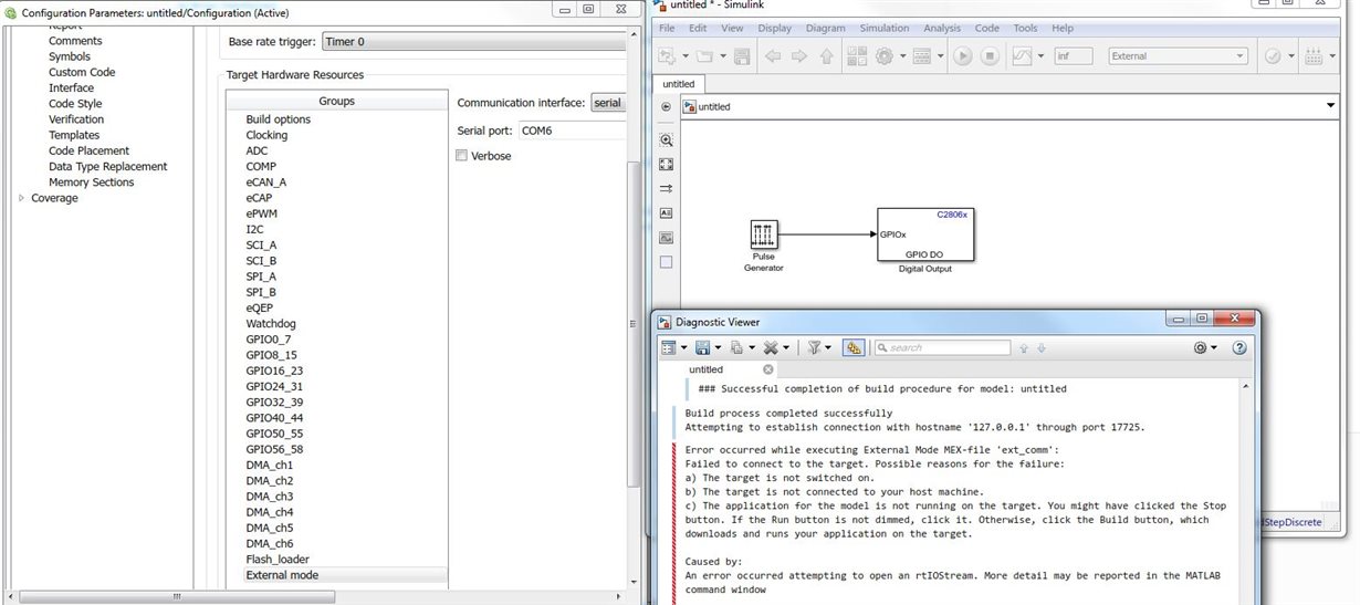

 I have been trying since 2 days to run simulink model in External mode. Everytime I do this, Error is appeared as below.
Build process completed successfully
Attempting to establish connection with hostname '127.0.0.1' through port 17725.
Error occurred while executing External Mode MEX-file 'ext_comm':
Failed to connect to the target. Possible reasons for the failure:
a) The target is not switched on.
b) The target is not connected to your host machine.
c) The application for the model is not running on the target. You might have clicked the Stop button. If the Run button is not dimmed, click it. Otherwise, click the Build button, which downloads and runs your application on the target.
Caused by:
An error occurred attempting to open an rtIOStream. More detail may be reported in the MATLAB command window
I have tried almost everything that i could.
Set the correct COM port (one can see in attachement). It is building correctly and uploading to HW.But after that it is giving above error.
Please help me to fix it.

  • Hi Rahul,
    Why do you have 2 XDS100 ports (COM6 and COM7)? How do you know you need COM7 (vs COM6)?
    I'd suggest cleaning this up, as maybe it is possible board is connected to CCS via COM6, and MATLAB cant access via COM7.  Note MATLAB does invisible calls to CCS for connection and download with the board, so you should not have CCS connected in advance as this may lock out MATLAB from being able to talk to the board.
    HTH,
    -Brian

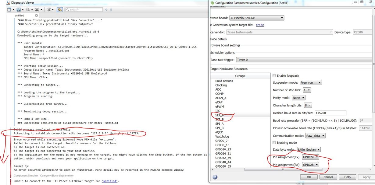

  •   Hello,
    I have done what you have instructed. You can also find it in the screenshots that i have attached.
    I did not start CCS(v7) even after restarting my Laptop and I dont know how this port error comes from?
    Any help to solve this?

  •  Hi,
    Can you verify once if the mux selection is a issue. You need have UART enabled on GPIO29 and 28. that is option 2 from table and the jumper settings for JP6 and JP7.
    And the same GPIO needs to selected under SCI_A pane in simulink.
    Venaktesh C

    the following is the content from file.
    Serial Delay : 0s
    TCP/IP Timeout : 60s
    Serial Port Settings Verify:-----------------------------------------
    Port : //./COM7
    Baud Rate : 114796
    Serial Communications Up. Listening...
    Starting server on - localhost/127.0.0.1
    Waiting for client on localhost/127.0.0.1:17725
    Time out, client did not respond within the time window. Quitting now...
    Thank you
